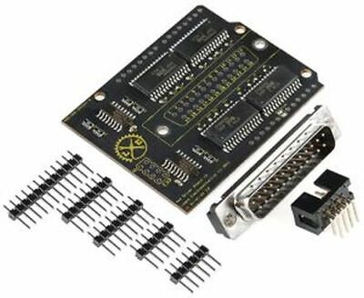

Arduino UNO has an interface that can accommodate various interface boards. Called "hats"
or "shields". These plug in to the headers on the UNO board and make life easy for many
varied applications.
Here is an example of a high side driver board, you can go to aliexpress, ebay for others.
Some versions of these boards have protection features as well.
