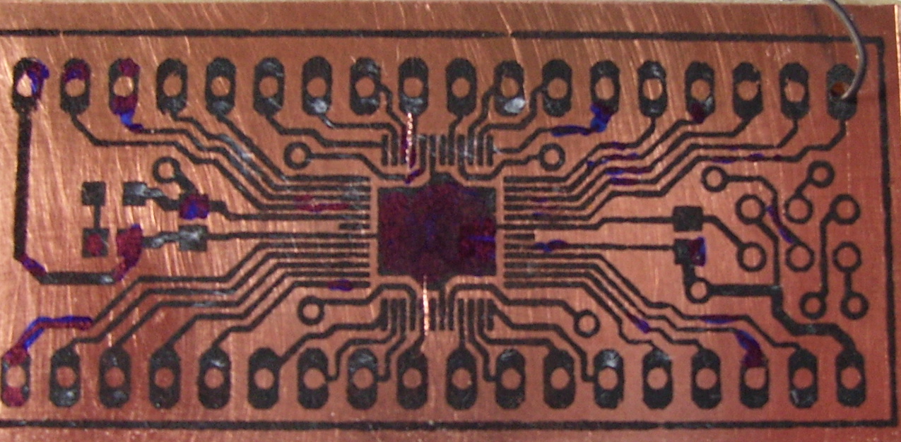

I realise lots of people will post pics of their diy boards but I'm after some constructive criticism.

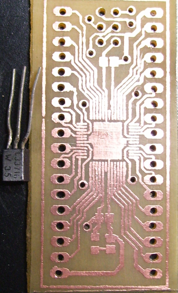

I made this CPLD (TQFP48-0.5mm pitch) - DIP adapter as a real test to see just what toner transfer can do. Materials used:
-Software: Eagle 4.12.
-Printer: Cannon LBP200i @ 600DPI.
-Paper: Stock printer paper. Tried magazines (thick and thin pages), glossy (for inkjet and laser). Every one but the standard cheapo printer paper caused severe smearing/smudging, and the staples photo basic wouldn't even come off after 24 hr's in soak. I'll try proper toner transfer paper (the blue stuff) later.
-Copper clad. Stock SRBP (FR2). Good enough for these circuits, and won't destroy my drill bits after a hundred holes.
-Etchant: Amonium persulphate 100g disolved in 500ml of warm water.
-Drill: Dremel 300, with HSS 0.8 (blunt) and 1.0mm (new) bits. PZ541 drill stand.
Results? well, considering the pads for the TQFP part were 0.5mm in pitch and 0.34mm wide..thats a gap of 0.16mm. Getting the paper out of these 'trenches' was tough, and meant that three of the gaps did not etch away properly, leaving shorts corrected by a craft knife. Some areas where the toner didn't stick too well were touched up with an etch resist pen. Which was crap and was quickly eaten away by the etchant within minutes.
I think I got the drilling down, despite some off-centre holes, and the ironing seems to require NOT the highest heat as that causes smudging but a pretty high heat, as qwell as a preheated board. But can anyone recommend some decent paper? Preferably stuff that DOESN'T smudge the toner, but comes off without 30 minutes of rubbing and swearing? God knows why people recommend glossy paper, every type I tried results in small pads becoming one large patch of toner.
Suggestions welcome! Next time, I'll try some photoresist, with washing soda as developer :D

Hi Blueteeth,
had similar/worse results trying to use all types of paper/glossy mag paper & etch-resist pen for touching up. Got p****d off trying to remove paper after soaking for ages in warm soapy water, lightly scrubbing with toothbrush, chanting with scented candles etc. and switched to Press 'n Peel...delighted with the results.:D
Good to see you are using a drill press, did you drill the board prior to etching or after? The reason I'm asking is...after etching, the holes left behind will serve to centre the drill bit much better than drilling prior.
Better than my first attempts BTW.

Yep, I drilled the holes post-etching. You're competely right, not only does the toner help to line up the hnoles by eye,. but the lack of copper also guides the bit. The 'mistakes' on the drilling I would put down to inexperience, lack of light, and a broken 0.8mm drill bit which I found on my desk lol. Did the job, but ripped off pads like theres no tomorrow.
Btw, that little board was part of a larger panel, since I could only make up etchant in 0.5L, was enough for a 100x160mm panel, but not too much to cause hassles with storage (plus, the stuff I use has a shelf life in days rather than weeks). I'll post some pics later once they have been depanelized.

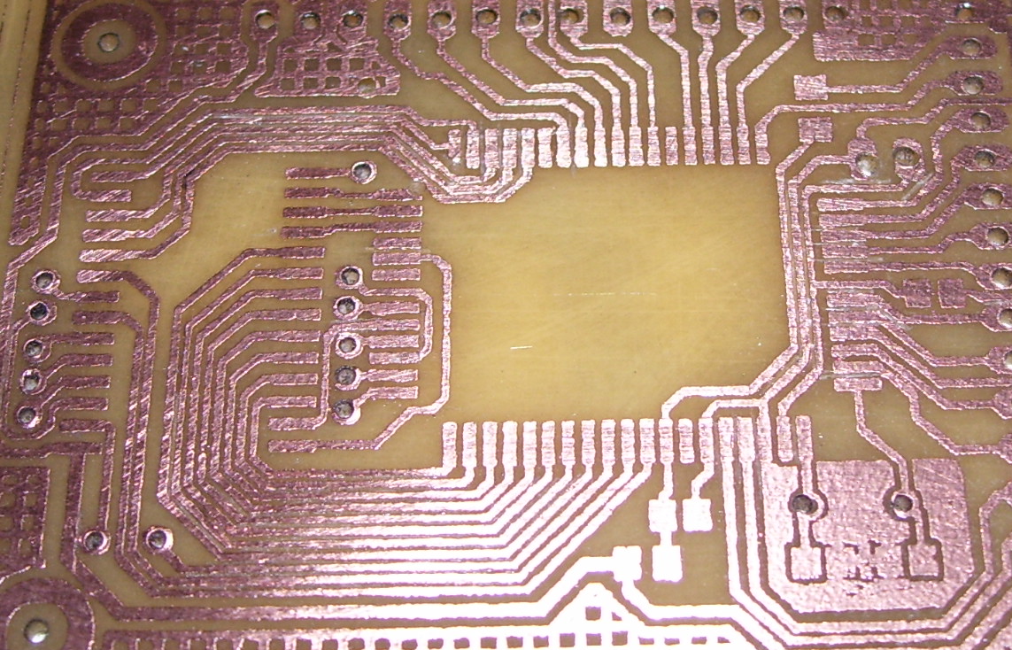

The photo on the left has a lot of lines shorted together and some of the lines look very thin.
The photo on the right is a negative pcb that won't work.
That looks good but I'd go down the photo route for something of that higher resolution.

Hi Scott,
a lot of work taking a close look at the many shorts on the PCB.
This already fine trace technology and asks for different methods.
Here's what I used to do in Germany: Went to a copy & print store (for newspaper advertising and small catalogues), took my Eagle CD with me and installed Eagle on their computer - then loaded the desired file and had a gerber photo plot made on transparent film. The charge for one film was 10€ regardless of its size, so making the board was pretty cheap compared with a professionally made board.
Using UV-resistant raw material (FR4 photolayer by BUNGARD) the board was of superior quality without corrections like carving with a scalpel, very close to the quality of the traces you can see on any mainboard.
To drill the board with holes exactly in the center of the pads I used a BUNGARD drill, a kind of drill press where you have the PCB on a flat table, and a viewing magnifying glas with a grommet underneath for exact positioning. The drill bit worked from underneath the table driven by a solenoid and activated with a foot pedal. This little machine also took care of the dust sucking the board material down the drill hole and from there into a vacuum cleaner. At 60.000 rpm the holes were smooth enough for electrochemical through-contacting.
Using a laser printer with a resolution of at least 1,600dpi (better 2,400) you can achieve similar results provided you use the printer manufacturer's suggested film. Those films have a heat protection paper layer (stick & post method) on one side and don't melt in the laser printer and there is also no distortion in the print.
The OP said there were shorts. He asked for constructive criticism. I think that means offering solutions, if you have them, to problems that you identify.
The photo on the right is correct. The dark areas are toner which will remain after etching. By comparing defects, I would say that both of the photos are of the same workpiece, on the right before etching and on the left after.
I think this was a very good effort, with better results than I've achieved with toner transfer. I still use inkjet transparencies with sensitized boards.

jpanhalt: Cracking idea! I have loads of ULP scripts for eagle, but rarely use them. Having a relatively small 'dot' in the middle of a pad, teoretically *should* centre the drill bit better, as well as easing it into the copper. With my 'standard' holes, by the time the bit had eaten far enough to start taking copper off...it was not so much 'drilling' as 'shearing' meaning tearing pads was quite common. That should sort it out a treat.
audioguru: You're right, the left one did have shorts (only 4 believe it or not), I guess my camera focus/tripod was the best. Sorted it out with a craft knife like a trooper. The right photo...well I thought it was pretty obvious that was 'pre-etch' just to show what the toner was like before etching, perhaps I should have explained it better. The shorts after etching were most likely because of residual paper in the trenches between pads, something press'n'peel should not do.

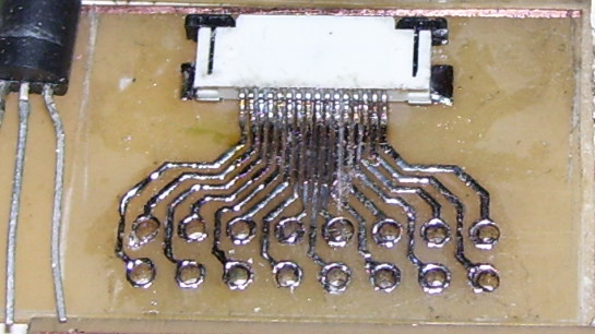

Last thing, a couple more pics, one FPC 0.5mm 16 way adapter. And one header board for an LCD controller. Both turned out surprisingly well.
