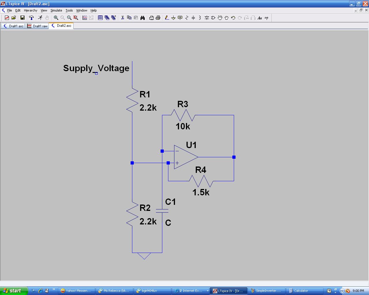

hi, ive looked at this one and the circuit looks fairly straightforward, i just got a little question or two about it if you would be so kind as to answer :D
firstly, is this correct?

Here's another fun oscillator to play with. It's simpler than the wien-bridge, but it outputs a square wave rather than a sine. The frequency can be changed by using different values of R3 and C. The frequency should be around 2*R*C. Using a huuderd or so KOhms and a hundred or so microfarads, you can slow the output enough to flash a LED. Oscillators are some of my favorite circuits. You get an output without the need to provide an input. It's like getting something for nothing.
Yes, that's right.

Just about any opamp will do, such as the LM324. The one you're looking at is probably adequate.
The opamps in the LM358 (it has two opamps) are exactly the same as the opamps in the LM324 (it has four opamps).
