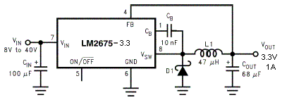

Surely a series reg, eg. LM317 would be more suitable?
For a zener shunt reg, say the input voltage is 12V (gel cell battery), the output 3.6V. You draw a maximum of say, 1A (for the flash), and wish to maintain the 5:1 ratio which Nigel suggested. So, the power dissipated by the zener is (3.6V * 5A) = 18W, and by the resistor, ((12-3.6)*6A) = 50.4W, a total of 68.4W wasted. This is obviously quite inefficient and unfeasible.
A series regulator would dissipate just ((12-3.6)*1A) = 8.4W.

For best results i strongly recommend a simple switcher buck regulator from Nat.Semicond. No heat, good efficiency, and the 12V battery life four times longer.
