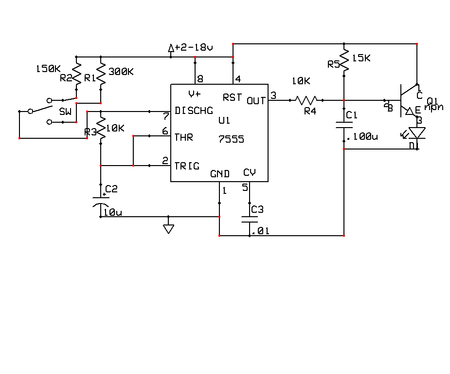

here is a possable solution
not tested but should work.
using SMD (custom pc board) it can be built smaller than
L 30mm x W 35mm H 8mm
looked at malpin they carry the 7555 but trying to locate a SMD ???
Please do not post circuits that blow up the LED because there is no current limiting.
EDIT: Also it won't work with a 2V supply because the transistor has a voltage loss of about 0.8V or more and an LED needs at least 1.6V.
oups forgot resistor
I used an example schematic from last year. instead of a single transistor it has a darlington etc.
suggest upping the supply voltage.
I'm still waiting on the transistor before building it but see the issue. I am basically going off your schematic MrDeb and plan to tweak where necessary. I was thinking of using either 3V or 6V. Should get transistors in a day. Couldn't find a TIP 120..
you don't need the tip 120
I copied n pasted from a larger schematic.
I thought I took that out??
for one LED all you ned is a 2n2222
sorry for the booboo
you still need to add a resistor to led depending on voltage.
see audiogurus post
I am basically going off your schematic MrDeb.
Don't make MrDEB's defective circuit:
The timing resistors are backwards so it will ramp on the LED fairly slowly then will try to switch off for such a small amount of time that the LED will appear to be on continuously.
But since there is no current-limiting the LED will burn out.
