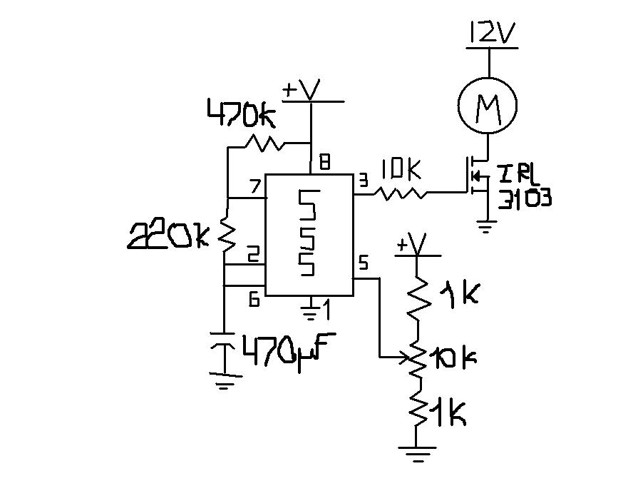

Hey,
New NOOB here. I want to make a timer circuit, that I can waterproof, to control the on-off cycle of a 12 volt DC, 3 amp or less motor.
It is the aerator pump for the livewell of a fishing boat. I would like to be able to have the pump come on for 30 seconds-2 minutes, then shut off for about 5-15 minutes.
As far as waterproofing, I intend to seal it up in silicone caulking or some such material. Even though it probably won't get wet, it is in a boat and the possibility always exists... :)
Thanks in advance for any help or suggestions.
BTW, I know a little something, something about electronics, but only as a dummy.
Please, dumb down your explanations, although if you link me to a circuit diagram, I can follow that pretty much OK.
I would also like to keep the whole thing under 2 inches square, if possible.
gus
Once again, this problem can be solved with a simple but reliable 555 timer circuit. It will easily run off of the 12V DC you supply to it and can controll the motor using an external current booster like a relay or a MOSFET.
I have attached a circuit that can illistrate the principal to you. The circuit will change states once every 7 to 8 minutes there about and the relation to on off time can be adjusted with the pot connceted to pin 5.
Sorry for the slopieness of the circuit, I didn't have any CAD programs to make it so I did it with MS paint isntad.
Your can play around with the RC network used for timing and can see if you get a better time constant 1.44*R*C= time in seconds

Thanks Vince, that should work just fine. I do have a couple of questions. I need some clarification on certain parts of the circuit. 1- V+ can be the same 12V battery voltage that I am using for the motor? and 2- the transistor? just below the Motor, IRL 3103, is that a TO220AB? 3- Obviously I will need to mount the 3103 on a heat sink?
Again, thanks, gus
Yes, most 555 timers can handel up to 15V easily and continue to work normaly.
Yes, that is a TO-220 transistor. I can't remember the voltage limit off the top of my head (I think it's 32V) but it can handel 64A of current so it should have no trouble with your motor.
Yes you should probably have a heat sink for the transistor but since it is only running for about 7 minutes at a time it doesn't need to be too large unless you modify the duty cycle. I would recomend making your heat sink as large as possible to avoid destruction of your transistor.
I also just realised that I did not label the pins for the transistor in that schematic.
The pinout is as follows:
1) Gate, this is connected to the 10k resistor
2) Drain, this is connected to your motor
3) Source, this is connected to ground
4) Drain, this is the heat sink tab on the back of the transistor and is connected to pin 2

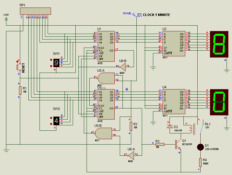

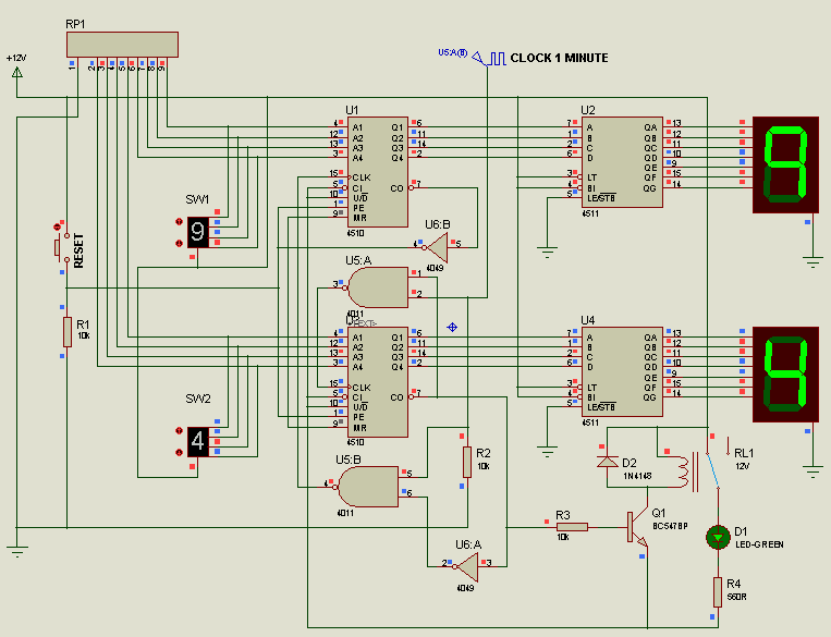

Here is a "super duper" timer circuit for you.
I designed it not to torture the fish before they land in the frying pan.
It consists of two timer circuits each triggering the other.
Starting the circuit the relay pulls in and switches on the load (shown with a green LED). Instead of using a relay for the air pump you might use a MosFet transistor like a BUZ11. At a current of 3A it doesn't need a heatsink. Bolting it to the metal case of the circuit you'll have a heatsink already.
When the activating timer has timed out it triggers the pause timer, which in turn triggers the activating timer when timing out.
Both timers are count down timers and can be preset to any value from 0 to 9 using decimal BCD coder switches.
When your fish start floating with their bellies upside you just hit the reset button which instantaneously activates the air pump and starts the timing sequence.
Too complicated for the purpose? I know people and therefor I love animals. :)
Regards
Boncuk

Thanks a bunch, Vince, Ken and Boncuk. You have given me plenty to work with. I am sure I will find one of the circuits will do the trick.
I like the first one, because for a NOOB like me, it should be inexpensive and easy to construct.
I like the second option, because if the first couple of attempts at building my own fail, I could just buy one of the many available kits.
And, third, I like the complexity and elegance of the last one, but I wouldn't have a clue where to begin.:confused:, quite a bit out of my league and over my head...

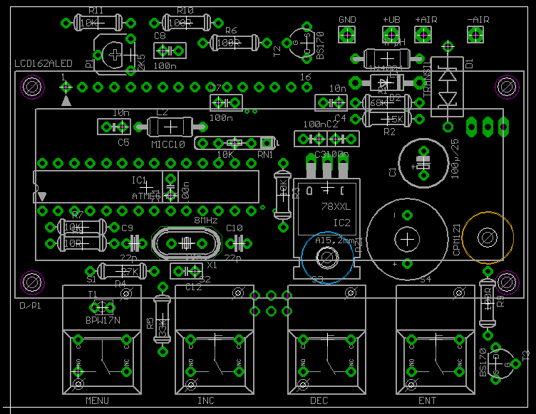

Hi Gus,
your PCB size limitation gives me headaches. :)
This time it's the display unit being larger than 3" long. The board I have designed is now 2.5X3.225".
Some parts have to be mounted on the solder side and since the PCB must be double sided that fact won't matter.
Here is a PCB overlook.
Boncuk
Hi Boncuk,
The circuit looks like a work of art, do you really think I can put this together?
Also, remember that I have to get all of the parts for this circuit from internet sources and price and availability are BIG concerns.
How big is the display?, I might be able to make an adjustment to my panel configuration.
Thanks again and Best regards, Gus

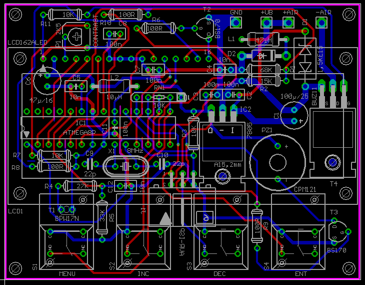

Hi Gus,
I think getting the parts from Mouser or Digikey should not be a problem. All parts are standard elements except for the microcontroller (ATMega8P) which will be programmed and shipped to you from Germany.
If so you might skip the 6pin R/A box header (ribbon cable connector) which is required for in-circuit-programming.
The 16X2 char. LC-display measures 80X36mm (3.15X1.147"). The board dimensions are 3.225X2.500".
The PCB layout might look confusing for a beginner. If you follow the assembly instructions I'll provide nothing should go wrong.
However some care has to be taken concerning proper soldering.
Regards
Boncuk
