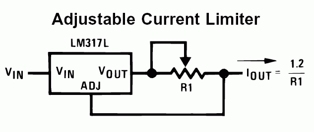

It looks like magnet that can move inside tube when shaken.
You also have coil fixed arround the middle of the tube which
creates AC power when magnet flies by.
The text mentiones white bright LEDs as source of light.
This makes sense because LEDs are much more energy efficient.
I'd try to use maybe 4 of them wired in series.
I think I can see some electronics too. I would simply use just
the tiny bridge rectifier, relatively large el. capacitor and simple
constant current circuit for the LEDs.
The constant current circuit is easily made using resistor and some
active component. I would just use small LM317L with fixed
resistor of 56Ohm. That should give ca 1.2V/56Ohm=21.4mA.

thanks!! but what type of LED? is it the one that is used on cellphone backlight? or the one found on old car stereo. sorry im really new. but i think its the LED used on cellphone backlight? m i right? or is it another type of LED?? hope u could reply again.
thanks again. sorry for my dumb questions but i dont know somebody i can ask.
also whats LM317L? what type of wire should i use on the coil and how long should the coil be? i hope u could help me. pls.
should i put the circuit that u posted here before the LEDs or before the coil? i would really appreciate ur help. tnx in advance!
OK, get back to basics...
First, the coil acts like a transformer, when a magnet is moved within it, it generates a current. This current will be alternating because the magnet will be moving in two directions. Hence you need a rectifier to control and change that alternating current into direct current...
Then you need to store it... a capacitor does this.
Have a look in Google for the LM317L. You will get what's called a PDF 'datasheet' on the device. The thought behind the LM317L is that it will allow the required current pass into the LED (around 20mA) and prevent a surge, because it will be very hard to control the voltage in this device!
So it goes:
COIL -> Bridge Rectifier -> Capacitor -> Current control -> LED.
The Capacitor will have to be very large, maybe 10,000uF and this may only provide 10 seconds of power to the 4 LED's if fully charged!
The bridge rectifier will ensure that no current is wasted, unlike a half or quarter wave rectifier.
Hope this helps...
