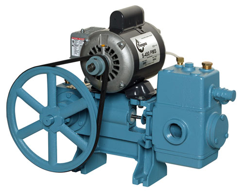

Flickering all ligts at home while water pump is switched on
I have compressor motor to pump the ground water(borewell). when i switch on the motor, all the lights(bulb, tubelights) in the house in flickering. What is the issue? is it some grounding fault or loose connection. How to troubleshoot this...

It's happening in my home too. We use a 2hp piston pump to pump water from a 200mtrs away open well down the valley.
It causes alternative flickering of lights during operation. I think because of the heavy load. A normal centrifugal pump causes the voltage to decrease a bit and remain constant throughout. Have you noticed it? What happens when we switch on a CRT TV? The voltage flickering is severe in places near to welding units.
