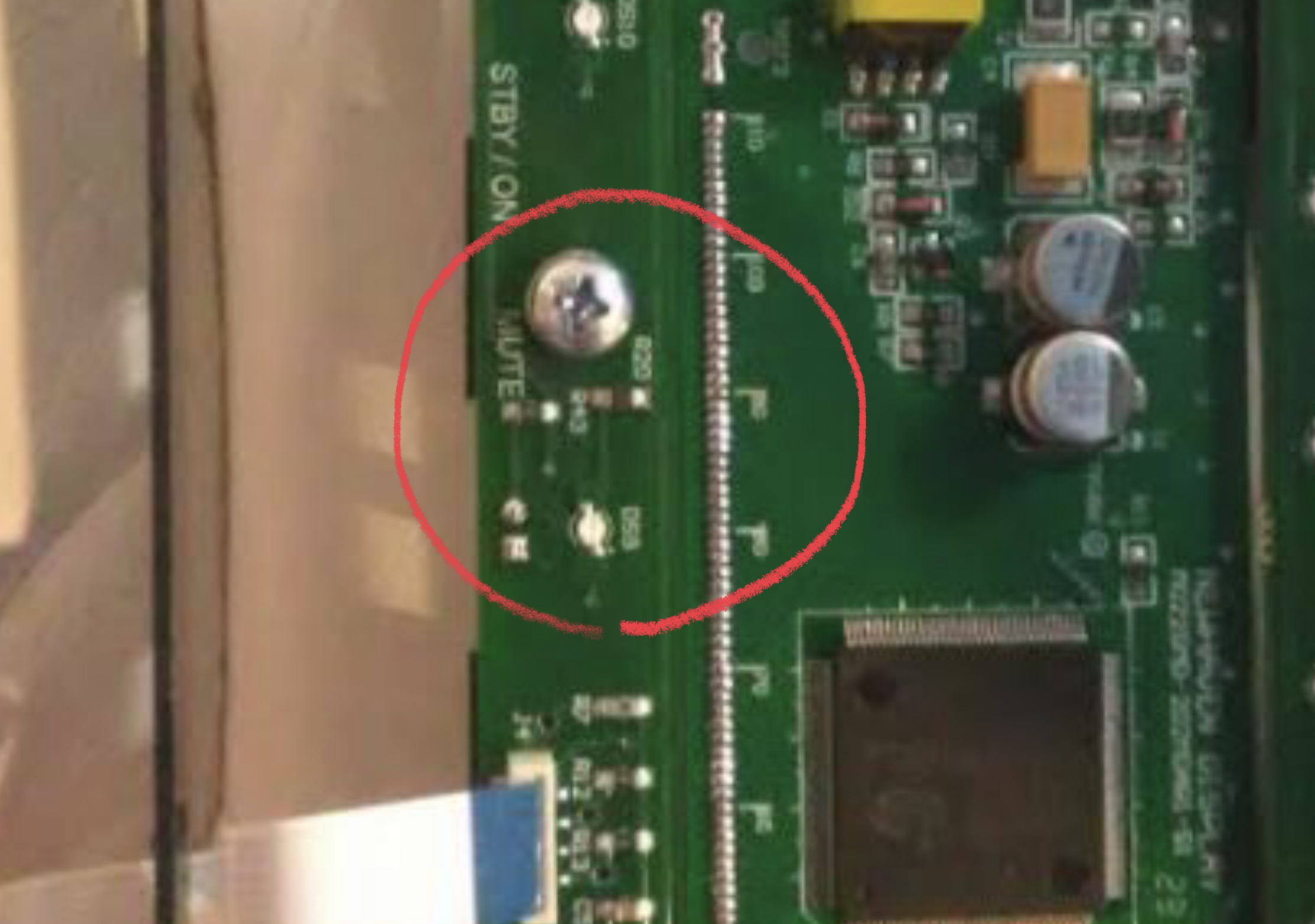

Flickering mute illumination LED on 4 yr old McIntosh Preamp

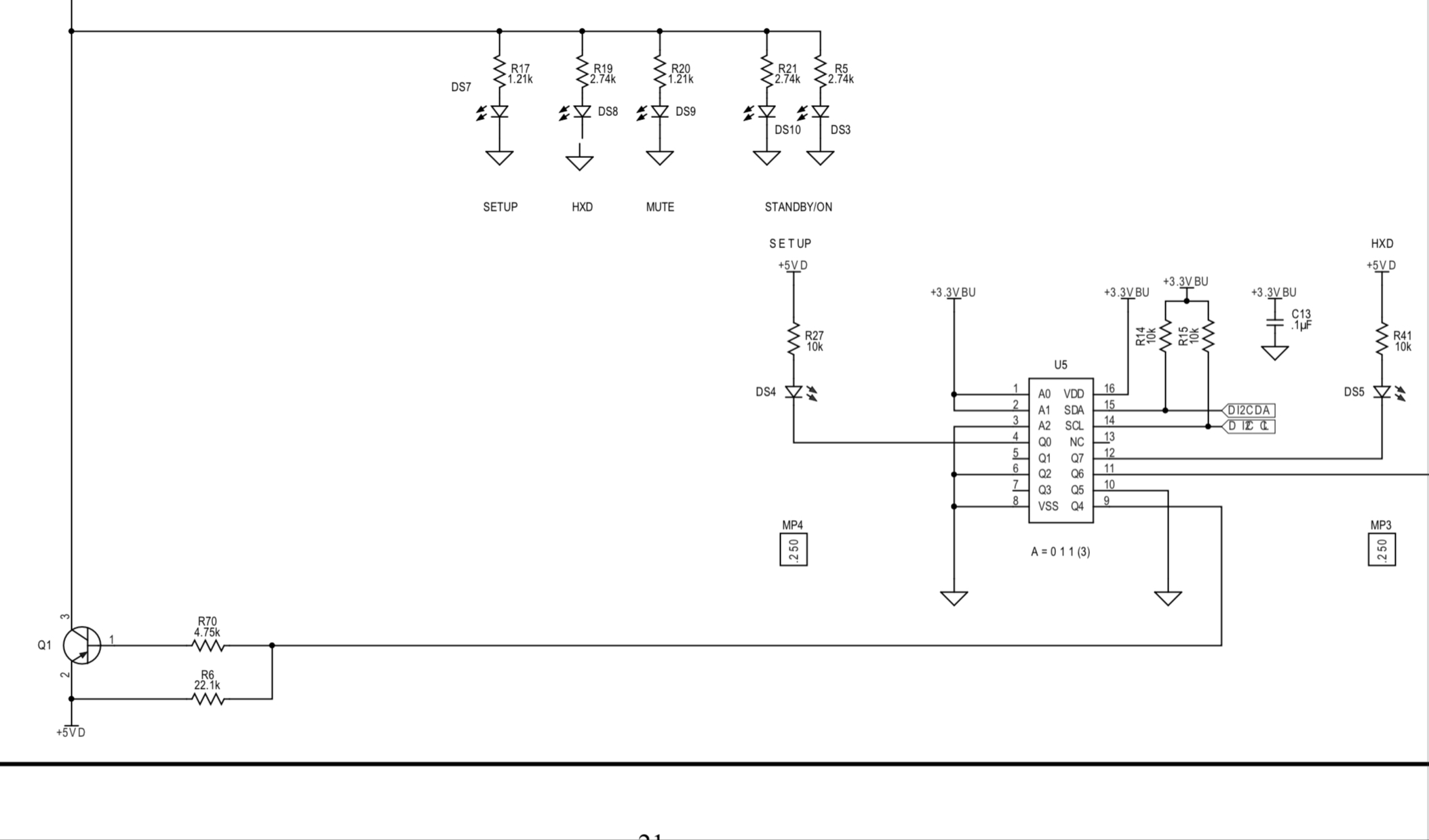

There is no possibility tat board will work. https://www.electro-tech-online.com/attachments/c1100c-aee-service-p-04165600-1-pdf.128765/#page=13 , there is no power going to the LEDs.
Anyway, expect it's 5V. That would make the LED current about 1 mA, Usually, it would be around 10 mA, but there are some high efficiency LEDS that can use 1 mA.
Looking guarantees nothing. Freeze spray isn't a bad diagnostic too;
Resistor looks like it has a gap.

Back to your problem. LEDs have a forward voltage drop depending on color. They also have a range. Vf also determines how bright they are relative to another LED. Mcintosh may bin them to get even brightness or the LEDs have good factory tolerances. Chalk up a reason for a new board.
Typically you series connect LED's and have some wiggle room left over. e.g (5-2.2*n)/2.74k is about 1 mA. n=1 LED, 2.2 because it's green.

If DS9 (small, reverse surface mount green LED) is the issue, then you're in luck. All of the little green LEDs on that board are controlled by the same 5v circuit and all are switched by a single PNP transistor. The one you are after is DS9 and DS7, DS8 and DS10 are all controlled by the same transistor. So, if the others LEDs I listed are working, the. It can only be the LED or the corresponding resistor (R20) or the solder joint on either.
Can the resistor be replaced? Can the LED be replaced? They both seem to be indented into the board.
Yes, they are just simple surface mount resistors and LED. The LED is pretty specific - called a down-firing LED. That means the light comes out on the side that is soldered to the board and illuminates through a hole in the board. You might want to order from McIntosch because there are so many options and matching the color of the LED, intensity and position (size) in the space provided so you don't get a shadow. The resistor is pretty common but, since your ordering from McIntosh anyhow, get a couple each (LEDs and Resistors) so you have a chance to practice your soldering skills. After all, there is a $10 minimum. Which city are you near? Maybe we can track down an experienced solderer for you. Otherwise we can get you some instructions. You should have a thermostat controlled iron.

R43 looks really suspect. Look at the gap carefully. You probably don't even need solder.

My plans would be to measure the resistance across the resistor and wiggle. You can do that if you have an ohmmeter. I'll look at the schematic and see if it's safe to apply 5V externally.

Give me any numbers/letters on U5.
Numbers/letters on U5? Need to get part number from the code and see if it's OK to apply 5V. You didn;t reply to a piece of our conversation. Tube amp storage.
Can you take a nice clear close-up photo of d9 and R20 (Mute) circuit.
no flash, steady hand, far enough away to get perfect focus (digital zoom would be great - just not too close so the camera can't focus). Brighter lights make it easier to get a non-blurry photo if you are far enough away.
