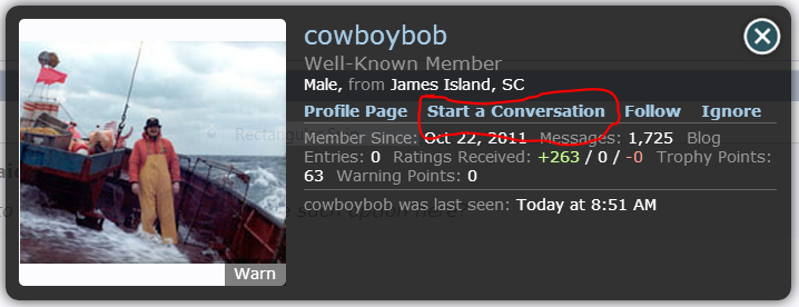

Easiest method is:
Hit the picture of the member you wish to message and hit the "Start a converstion" button.
Then hit the "Start a new conversation" button.
Fill in "Conversation title" and then your message.
As to your post question, google "flip flop electronics explained". Start with the Wikipedia description.

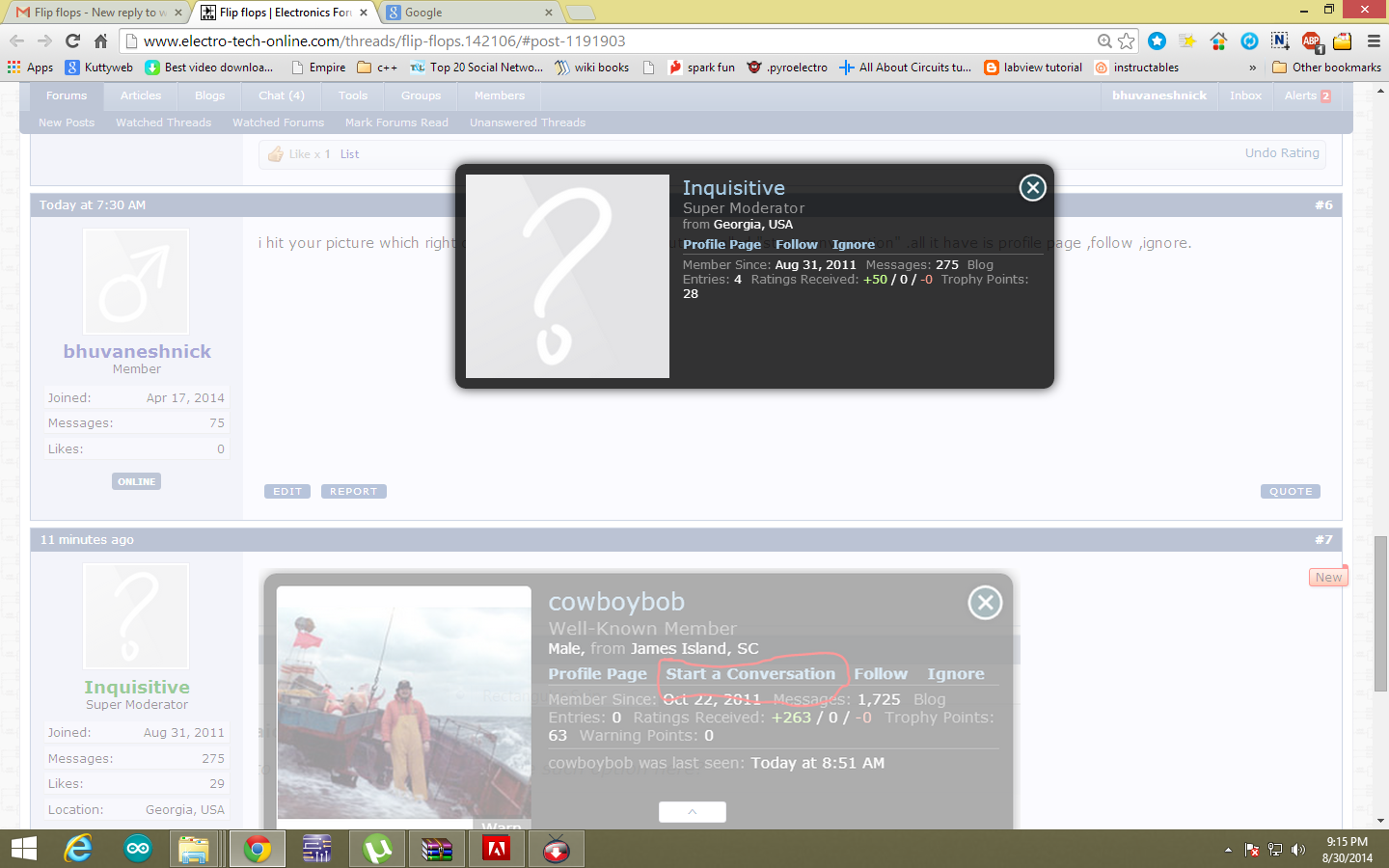

i hit your picture which right of your picture but no such button called "start conversation" .all it have is profile page ,follow ,ignore.
See it now?

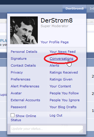

Hi bhuvaneshnick,
Do you have the "Conversations" link in your user menu?
