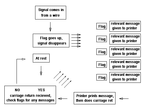

So what shape is for a state of rest, thats the starting point.
Regards, John :)
This is a very poor imitation of a flow.
Thats because i dont know what does what,
but even from this i can see there is a sort of loop.
it will check round the flags,
until it gets a "no more flags"
then it will go to rest.
Until another 'event' occurs.
Please help me to put the appropriate boxes,
and i may be doing it a silly way ....
There might be a much better way of doing it.
Regards, John :)

The Diamond is usually used for a decision, with the points being the Yes or No options. A Box is usually a process/function. For example, a box might read "Make pin 4 high"; the Diamond might read, "Is pin 4 high" with yes/no options. There is not a firm standard as to whether the "no" option exits the diamond to the side or bottom. I generally make "yes" the straight down point and "no" the point to the side.
A "product" is often indicated by a wavy sheet of paper, but frequently other icons are used. Arrowheads are used as needed.
I find PowerPoint my favorite for flowcharts. this tutorial is probably overly simplified, but it suffices for most of what I do. John

A flow chart is just a way of codifying your program logic. The thing I think you are missing is that it is supposed to show program execution flow. Your first attempt seems static. I would go and look at flow charts others have written to get a sense of how people use them. understand the program logic defined in the flowchart and see how the author expressed it in the flowchart. It should become fairly clear.
Boxes are for linear sequences of instructions, diamonds are for conditional (i.e. branching) instructions. There are different symbols for input and output. However, I wouldn't think in terms of instructions but rather logical sequences.
personally, I use pseudo code to design. It's closer to the final program, more structured and is more the way I think about program logic. Flow charts don't encourage structured design.
I would write your design as
while(true) // forever loop
    read printer input
    if carriage return then
        if flag then
            send relevant message to printer
        endif
    endif
endwhile
this seems a lot simpler to me than a flow chart.
of course, I would break out the different flags and specify them individually.
also, I don't think the logic in your chart completely makes sense but that's a different topic.

It now seems to me that to lay out a flowchart, one should already
know which bits affect other bits, and how they interact.
I now think that trying to draw a flowchart is not going to help me
to sort out the order of events.
Philba, thank you for the small piece of "pseudo code" which looks
like a stylised form of basic. I have been trying to follow it, and
i am encouraged by the style.
Although i am not sure about the bit: forever loop.
This position, which i describe as 'at rest' could better be described
as 'off'.
And i think that you are right about 'flowcharts dont encourage
structured design'
I will try to lay out the way i want it to work in normal language,
then maybe in short "basic style" notes.
Cheers, John :)

Hi Y'all,
Rough draft.
0. At rest Doing nothing. Maybe even turned off.
1. A signal comes in on one of the wires. usually the wire will go to 12v briefly.
2. Flag sets. The appropriate flag gets flagged up, because the signal often
disappears after a second or two.
3. Printer activated, message printed, carriage return activated, that flag re-set.
4. Remaining flags checked, in case one came in meanwhile. If so, go to 3, if not move on.
5. At rest Doing nothing. Maybe even turned off.
This is not expected to pass muster, its only a first draft.
If there is another, or a better way of doing it please let me know.
That should give some idea of what i'm after.
Regards, John :)

Hi, I'm not entirely sure I agree with that. We weren't told to use flow charts for programming in uni (if I can remember), only in 'state machines' for CPLD's/FPGA's, but it has helped me a great deal to get an idea clear in my head and on paper. Loops, subroutines, and 'if/then/else' decisions are a lot clearer when you have a 'diamond tree', with simple 'yes/no' outputs. I'll definately agree its not a magical method, and its certainly not for all situations, but as an intermediate step between idea and (pseudo) code, it works for me quite well. Sounds like you could use a 'case' statement in there for all the events. Which is really just a 'decision tree', or 'chained decisions' where you check each flag in turn...if yes, do something, if not check next.
And just looking over waht you want to do, a flow chart would be simple, possibly pointless. As for specific symbols....I only use three:
statement: this is where you 'do' something, one input and one output. You go to the statement, it does something, then you move out of the statement to something else. Like printing a line on an LCD or something, print 'h', print 'e', print 'l' etc...
Decision: This is simply a boolean type affair, a question or decision to which the answer is 'yes' or 'no'. one input, two outputs.
And, just a final symbol for linking up 'parts' of a flow chart, like 'goto' sections conntected to A, B, C etc.. because sometimes it gets messy very quickly.
It really is basic, and I've never felt the need to use proper complicated ones with dedicated symbols for specific purposes, just a visual aid for a process.
