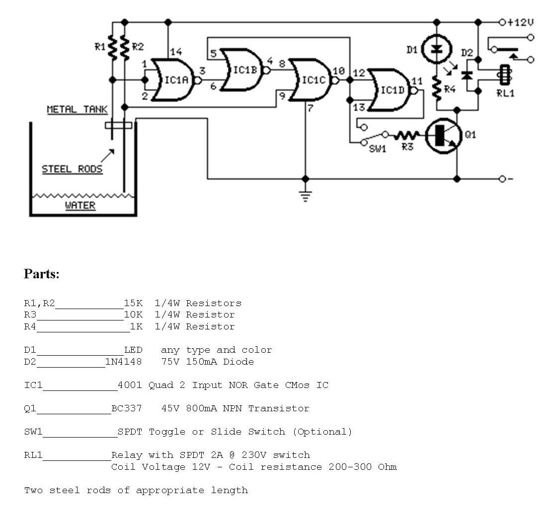

you can use ordinairy float switches (available at every plumbing shop) or make a sort of sensor probe model your self (also comercial availible)
the circuit i post is a fluid level detector and works fine (from experiance)
keep in mind that over the years some corosion will occure on the probes so make something that the probes can be replaced
sucsess
Robert-Jan

Maybe it will help!

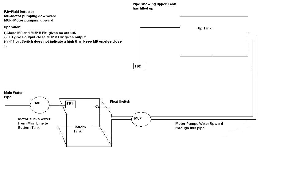

well i can not access the upper tank cause it is selaed.when it is filled water comes out through a pipe so one knows it has been filled.i intend to use a fluid detector there,another one for the water coming from the main water pipe from the supply system,and one for the level on the ground water tank. following are the conditions:
1)close both the motors if the water from the main line stops.
2)there are two conditions:
2(a)close the upper thank motor only if it fills up and the water level in the bottom tank is lower than the prescribed level.
2(b)close both the tanks if the upper tank is filled and the water level in the bottom tank is on/above the prescribed level.
PS:i intend to use a uc.
can you draw a simple drawing of the phisical tank and the conections and pipe work

yeah i am going to upload a drawing as soon as possible.there is actually ahole as said before through which a pipe comes out indicatng the tank is full.i will look in to the ping pog ball thing.thanks for the reply.
here is the diagram. it took me pain staking work to build it.!!!

Normaly you would fill the higest tank firts and from there you control the flow down wards
I don't know what the tanks supplying and what the pressure requirements are at which volume
asuming that you don't need a a pressurized sytem from the tanks than use one pump to fill the higest tank you will need only a high level sensor in that tank
instead of a second pump you will use a float valve to fill the lower tank
in case you want to have a fail safe protection than put a solenoid valve extra in the suplyline of the lower tank and control it with a high level sensor in the lower tank
anny problems to excute it like that??
if there anny phisical obstructions please post a photo of it and i might be able to help you out with advise
for sure the system aproach i discribed is cheaper than what you put on paper
