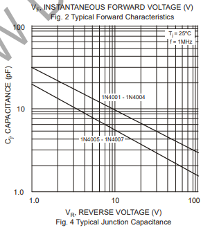

It might be a bit of a 'black hole' - but the excellent old UK Magazine 'Radio Constructor' published endless radio designs, as well as loads of other stuff - you can find most of it here:
Use of varicaps and considerations, some excellent notes here :
C range everything if you are doing a receiver :
The 1N400x series have been used but they have a limited range of C for reasonable Vrevbias
control voltages :
As you can see the Rev bias range of 1 to 10V (a reasonable control V range)
only gives a ratio of ~3:1. The hyper-abrupt varicaps usually highest ratio.
If you wanted a 10 : 1 range in freq you would need
Looking at Digikey I can see a max of 25:1 (not sure of V control range to get that). I saw a part
yesterday that was 56:1, now cant find it.

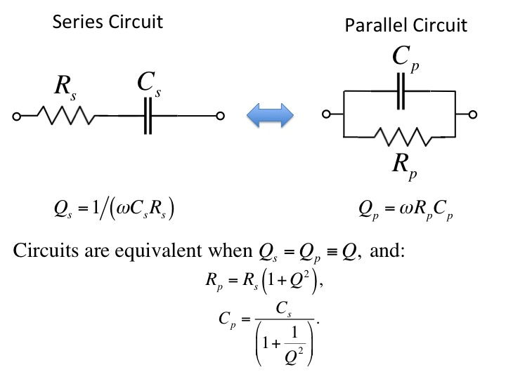

There are alternative ways, like using a variable R in series with cap, to produce an effective change in
its parallel equiv C. But that de-Q's circuit so demands more G in oscillator loop and a whole bunch
of other considerations.
The series to parallel transofrmation (useful in impedance matching work) to find the equivalent parallel
C of a series RC circuit :

Yes, the Cmax/Cmin ratio is rather limited for diodes like the 1N4001.
This will give a range of Fmin to Fmax which is significantly less than the range of the medium wave broadcast band.
Varicap diodes have been made for this tuning application, the BB212 is a typical example with a wide Cmax/Cmin ratio.
I am sure that other diodes suitable for this application are available, but whether they are available in Fluffys location I do not know.
I tried few different diodes and noticed I can tune to my 1.2Mhz radio transmitter with 1n5819 diode as varactor but range was very limited as expected.
Did you try your 1N4001?, as the one you mention is a Schottky rectifier, and I've no idea who well they work as varactors?.
I'd 'imagine' that they would be poor, as presumably they have low capacitance, in order to increase their speed?.
Also, what voltage did you have feed it?, as you need quite a voltage range to get the most change.
