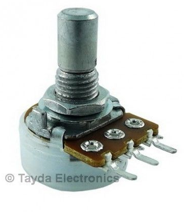

You can still use your 500 Ohm pot if you insert a 510 ohm resistor between it and gnd.
That will make the total 1K. It will limit the voltage range of the pot though. Instead of 0 to 4.5 Volts, you'll have ~2 volts to 4.5 Volts.
That should be OK as the fan not likely to have much usable range below 2 Volts.
Thank you. I thought that would work.
I have a few of these but for this project I want the adjustment available from outside the box.

Im going to get 500R like in post 29 and pair it with a 510R resistor
Can you help me figure out what i have done wrong here? Did i mis-interpet the schematic you provided in #24?
It only works if i remove the GND from pin3 of the pot. But the the pots adjustment has no effect. If i do have the schematic right then my BB is wrong. I added a pic as well.
I think the 510 Ohm resistor shoudl be between the pot and ground (in series with pin 3) not in series with pin 1 ??
