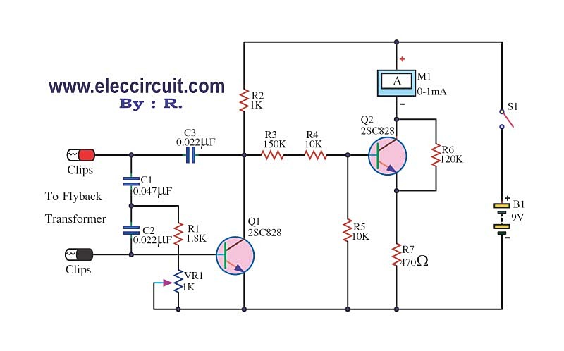

The circuit tests a flyback transformer of the televisions that the result is a simple, easy and cheap to build.

- I suggested he try to build this flyback transformers circuit. It has the advantage of a simple, cheap and easy to use. Because of the things he used to have, almost would not have buy more it. And very cheap compared to the flyback one.
How it works
As shown below, as simple circuit with the two most important components are
- The oscillator circuit use a transistor Q1 (2SC828) is base works with three capacitors C1,C2,C3 and three resistor R1,R2,VR1 to To produce a sine wave frequency.
- The current amplifier and detect circuits has transistor Q2 (C828) is used to increase the signal to works with four resistor R3,R4,R5,R6, And R7 is used to limit current to the amp meter, If you choose the amp meter that use lower current, so use a resistance R7 increase up.

Begin, place two probe at twin pins of the good flyback transformer, then turn on switch S1, if you can read the current approximately 0.1mA, Show that, the oscillator circuit is not working. to adjust VR1 reduce value its steadily With the observe the meter. If you read value is 0.4 mA, Show that, the oscillator circuit has already started.
If you try to bring the probe to touch together (Short together) to see that the meter needles falls down. Show that, this flyback transformer Short certain oscillator will stop running.
If measure transformer to the other, must adjust VR1 to meter reading is 0.6mA. If it normally, the meter needle will wiggle back and forth a little bit. If that transformer is “Short Round” the meter needle will down.
