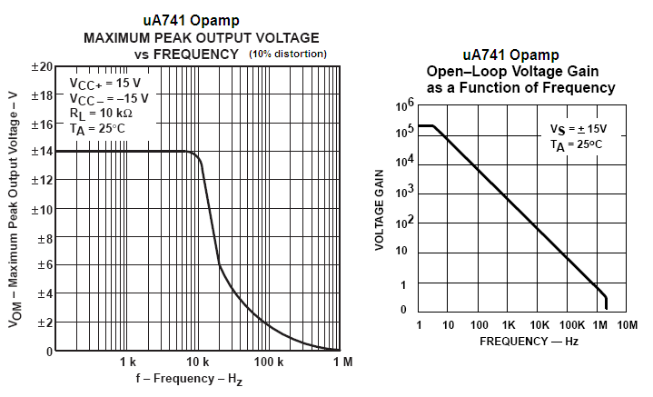

Most ordinary opamps don't work at 100khz. The 741 opamp has trouble above 9kHz.
