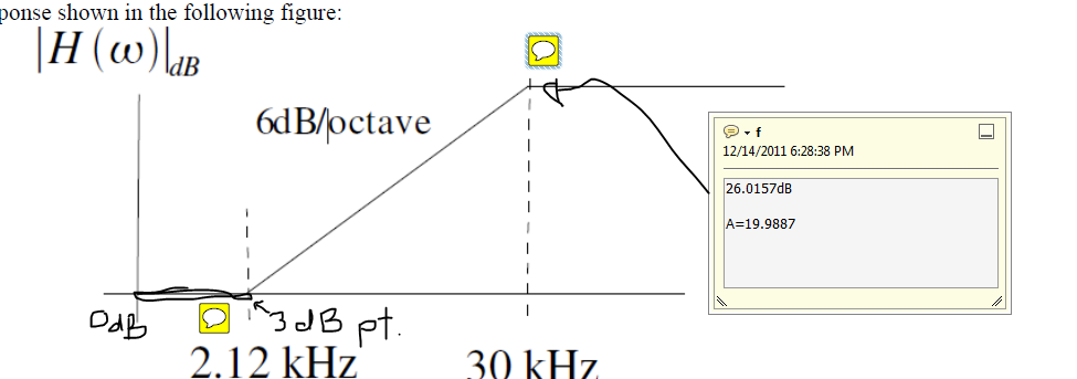

hello.. I'm here to ask about fm pre-emphasis..

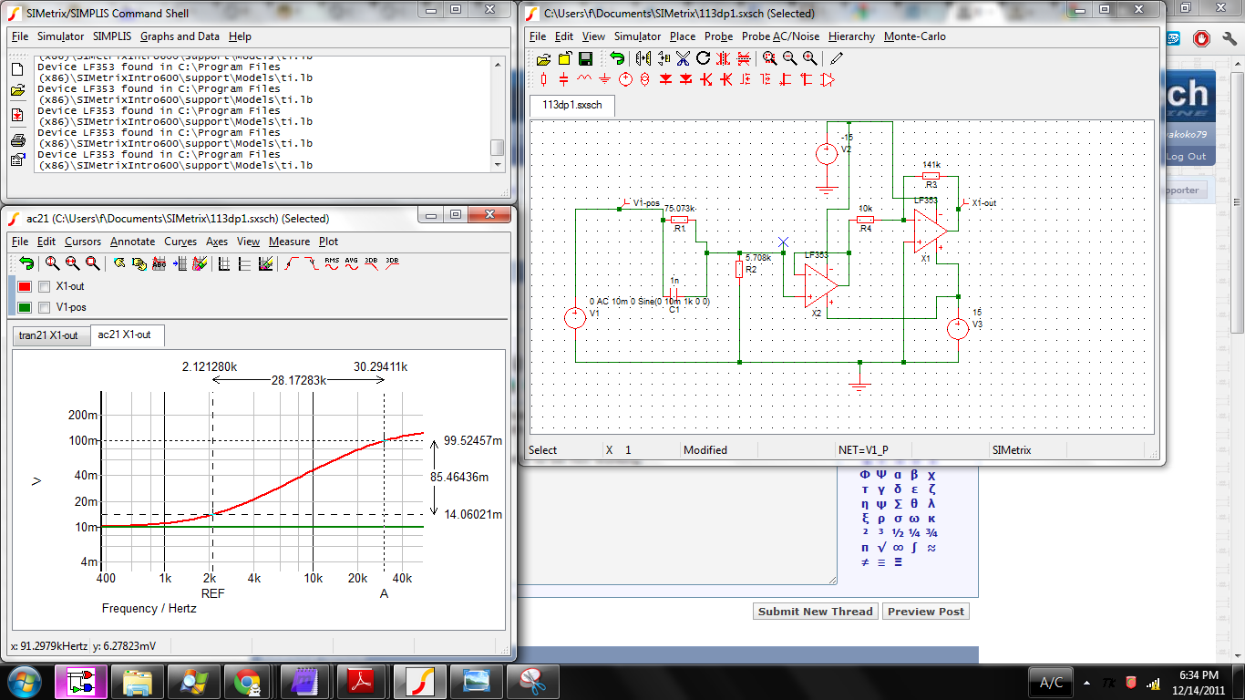

we are to make a pre-emphasis circuit with this response:
I used a simple rc filter to do it but it seems to be not working as expected..
the gain at 2.12kHz is around 2.99dB, which is fine since its the specs...
the computed gain at 30kHz is 3+20log(30k/2.12k)=26dB..
but as can be seen on the picture, the gain @30kHz is 20log(99.52/9.96)=19.99dB
*(9.96 came from the flat line at low freqs, not show in the picture)... this is quite far from 26dB..
Any advice about getting the gain higher at 30kHz? One more thing, the slope isn't actually 20dB/dec, its around 17db/dec.. is this really like that in the real world?

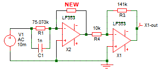

Your RC is feeding into a resistance instead of feeding into a very low impedance like the inverting input of an opamp.
Pre-emphasis for FM radio stations stops at 15kHz then a sharp lowpass filter cuts frequencies higher so that they do not beat with the 19kHz stereo pilot signal.
Try it like this (the sound source must have a very low impedance):

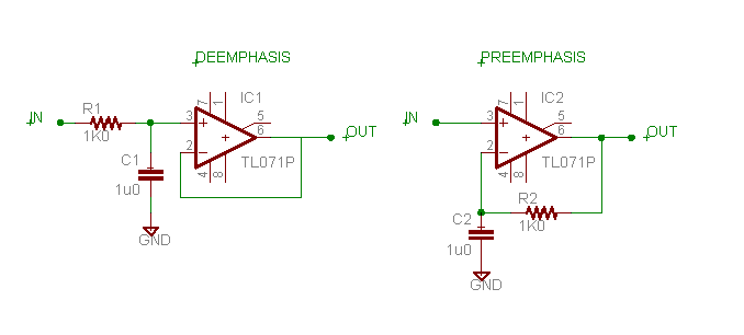

FM pre-emphasis standards vary from country to country. In North America, we use 75 microseconds as the RC time constant. In Europe, I believe that it is 50 microseconds. You already know this. I'm just adding it for beginners reference.
The 75 microsecond standard calls for a single pole filter (6dB/octave or 20dB/decade slope) and a corner frequency "f" of 2122 Hz, where 2*PI*f = 1/t and t = 0.000075. Simply put, The R in Ohms and C in Farads multiply to give you the time constant. Here is an illustration I made. Just adjust the values of R and C for your time constant.
You can also change the gain as needed. Note that the circuit marked "de-emphasis" is sensitive to driving impedance, which should be very low as compared with the value of the input resistor.

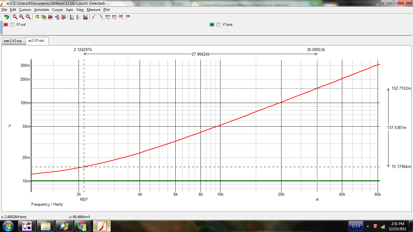

I tried it. here's the response.
then I put a simple low pass RC after it.. the response is still ugly...
It is perfect. The rise is exactly 6db/octave like it is supposed to be.
You are not supposed to use a simple lowpass filter, it is supposed to be a sharp filter so that 15kHz is passed but 19kHz and higher are attenuated.
