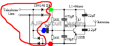

I want a simple FM transmiter but all i found had a electret microphone and i want to input from my computers sound card.
by the way
The telephone transmiter is nice and simple.But i dont want it to use whith an phone (it probobly dosent even work whith ISDN)
So if i remove the things in red
and if i conect to the spots:
-RED : Ground
-GREEN : +9 VDC (I think there is 9V in the telephone line)
-BLUE : the signal from my sound card
Wod it work like that ?

It dosent have a simple transmiter and i dont understand that language (i know English,German and Slovene)
ermm, i'm not sure, however, I think that if (where the diag says to connect the telphone line) you connect the ground and one of the signals from your sound card, it should work :)
try it, see what happens.

The simple FM transmitter is too simple:
1) Its tuned circuit is connected directly to the antenna. So if anything gets near it then its frequency will change.
2) It doesn't have a voltage regulator. Then its frequency will also change as its battery voltage runs down.
3) Its input sensitivity is about 5mV. The output from your sound card is much too high and an attenuator is needed.
4) It doesn't have pre-emphasis (treble boost) like FM radio stations have so it will sound very muffled (without treble audio frequencies) when heard on an FM radio.
5) It has a very weak output power and might not have a range to across the street.

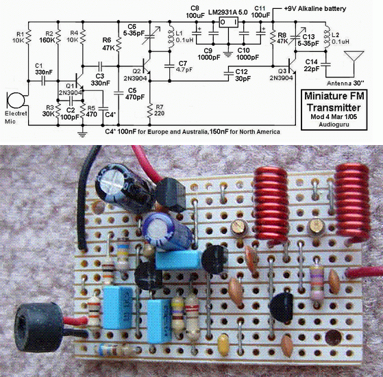

My FM transmitter has an RF amplifier transistor to isolate the antenna from the oscillator's tuned circuit.
It has pre-emphasis so it sounds crisp and clear.
It has a low dropout voltage regulator so its frequency doesn't change as the battery voltage runs down.
But it is not simple and it is not stereo.
Very nice, thank you. Maybe I will try to build it this week. It looks small enough to be mounted in my helmet for my gmrs mic, too.
Do you have a rough idea of the power out and consumption?
I think my FM transmitter has an output power of about 220mW but others say it is only 20mW.
It draws 53mA from a new 9V alkaline battery.
You normally measure the DC input to the output stage, NOT the actual RF output itself.
I find 220mW very hard to believe audioguru.
Have you actually measured the RF power using calibrated equipment?
The simulation I performed on your transmitter gave a waveform of about 3.3V peak, which would deliver 76.2mW into a 75:eek:hm: load, given that there will be losses in the aerial the final ERP will probably be about 60mW.
Even higher RF output appears purposeless, as the impedence matching and ANT gain matter for radition efficeiency- once Audiogruru quoted the coverage with this MOd4 device as few KM-- it only proves how effective were his ANT management .
My antenna was just an 80cm piece of wire hanging out a window. The range was across a very wide and deep river valley to my very sensitive car radio. The range was much less to my Sony Walkman radio.
