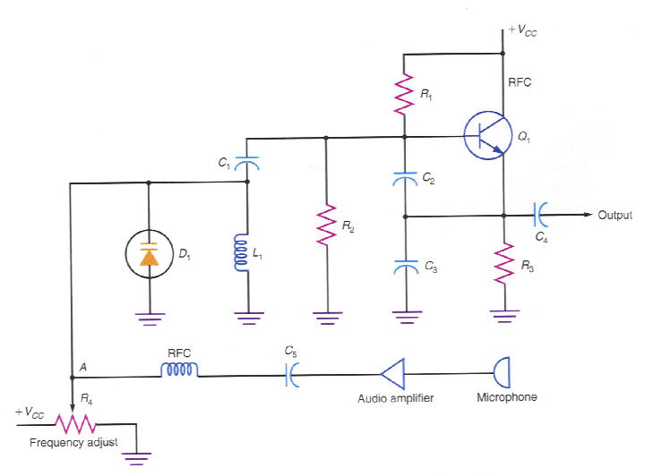

I'm having trouble with the analysis of this circuit **broken link removed**

My question is: How does this circuit act as a colpitt FM oscillator. Most of them I've seen are directly attached to the base.
Secondly how does this circut actually accomplish frequency modulation: Please use math on me!!! (I know that it should change the delta F term in the equation cos(2*pi*fc*t + δF) to achieve FM, or more correctly: cos(2*pi*fc*t + δf*∫(messageSignal))
How can I determine the Frequency deviation of this circuit?
Please use Engineering terminology and Mathematical equations in your analysis: Im a Senior year EE.

Frequency deviation is accomplished by changes to the base voltage. This affects the Base-Collector capacitance. The tuned circuit is also changed when anything gets near the antenna and of course it drifts as the battery wears down.

I realize this is a horrible design becuase the Qpoints are terrible (biasing Q1 at .9 volts doesnt allow for much negative voltage)
Can you explain how it changes the capacitance, my semiconductor theory about BJTs is a bit rusty.

I don't consider this a colpitts oscillator. Please see this thread for more information. There is a link to a pretty good analysis in that thread.

I don't think modeling this circuit is practical. It depends on the changing output admittance (real and imaginary) of a transistor as its base voltage changes. I don't expect you will find such a detailed model of the 2N3904.
Somebody probably built this circuit either intentionally or by accident discovered the frequency varied as the base voltage.
If you want an inexpensive circuit that you can model and understand, build a real Colpitts oscillator and use a small varactor in parallel with its main tuning cap.
I found this real example in this presentation: https://www.technology.heartland.edu/faculty/chrism/data%20comm/Power%20Points/ECS%20PPTs/ch06.pps
