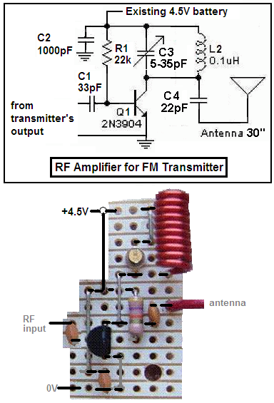

I'd like to go with modifying my existing unit. I might try using AudioGuru's amp from another thread. Do I run the risk of burning out my transmitter by connecting the antenna to this circuit?
My RF amplifier has a 33pF input capacitor which protects the transmitter from damage. This one uses a 4.5V battery for a fairly high power output. Another one uses a 1.5V battery for hardly any output power (like the BA1404 IC). My FM transmitter is designed for a 9V battery for plenty of output powetr.
Could I just strip the insulation off the end of the 55" antenna coming out my transmitter and connect it to your RF amp? Or would I have better results (less interference I would think) if I cut the existing antenna off and connected it directly to the transmitter?
Connect the output of your transmitter directly to the input of the RF amplifier circuit with the shortest wires (output and ground) you can.

I think this transmitter is very likely be made out of a BH1417, and since the RF output of it is weak, a single stage amp made of a transistor might be already added, then about 10-20mW can be produced. to reduce the size, the ant is just the audio line (an inductor isolates the audio and RF signal). so, if you wanna improve the range, it is better to isolate the ant from the audio line, let your metal house be the ground, and set up an ant above the house and be sure it is isolated with the metal house.
