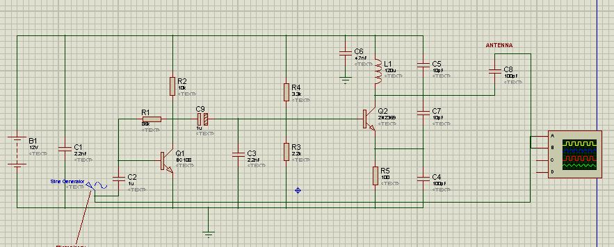

I have made different simulations but none of them is giving the required output. I connected an oscilloscope instead of the antenna to get the modulated signal but the output at oscilloscope is certainly not the correct one. I am attaching the snapshot of the output.

Please post your schematic, and say what you expected and what you measured.

all i can tell from the scope picture is that the OP has a 1khz (not 100Mhz) sine wave, and something is turning on and off in the second trace
DSN files don;t do us any good.... do a screen shot of the schematic, and don't zip it.
The schematic has no contrast, has a dark background and is covered with a grid. Things are difficult to see.
It looks like a simple FM transmitter.
The modulation level is 150 or 500 times too high so the preamp transistor is clipping and is causing the oscillator to turn on and off at the modulation frequency.

An oscilloscope will not show the tiny frequency change in a VHF FM transmitter. At maximum modulation the frequency changes only 75kHz which is almost nothing at 100MHz. You might see the small amount of AM produced by this circuit.
