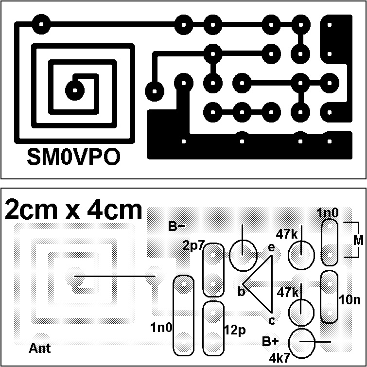

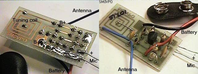

I think I have the ideal one. The simplest I could find. The only problem is that you'll have to rescale the PCB draw until it suits the real sizes. The great advantage of this circuit is that it has the coil printed on board and the whole circuit is extremely cheap (2-3€). It works amazingly around 104 MHz. The worst point is you can't touch it or the frec will change.

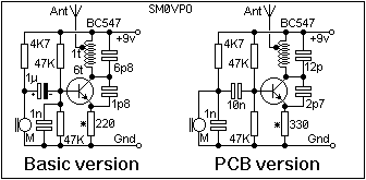

what transistor is used in that circuit?
what does the "M" in the upper right side mean?
how bout "B+" and "B-"?
what is that component above the base of the transistor?
where is the input and power supply?
what is the power output of the circuit?
thanks
Just think on the PCB version.
> The BC547 suits ok the circuit.
> The 'M' is just the microphone (electret)
> B+/- are the contacts for a 9V batt
> That component above the base of the transistor is a 330 ohm resistor

Skyknight, could I bother you by asking what is the inductace of the coil? I would like to make an aircoil because then i can get the transmitter even smaller. (the transmitter with the coil on pcb)
Thanks, hantto
No need to answer, I figured it out by myself :)
The coil is 0,195uH isn't it?
Yay! I'm happy! :D I have made a great step in electronics today :) I can now calculate the frequency of a inductor condenser oscillator!
