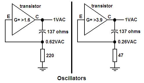

The feedback capacitor plus the transistor's capacitance plus stray capacitance forms a voltage divider with the emitter resistor. In my FM transmitter's oscillator, if I reduce the emitter resistor to 47 ohms for a higher power output then the transistor would need a gain greater than 4 to oscillate.
Why would it require higher gain?
I am lost now.
MStechca,
Don't you know that an oscillator needs a gain of more than 1 to oscillate?
If you use a voltage divider to reduce the feedback signal to 1/4, then the transistor needs a gain of more than 4 to oscillate.
I knew they need a gain more than 1.
