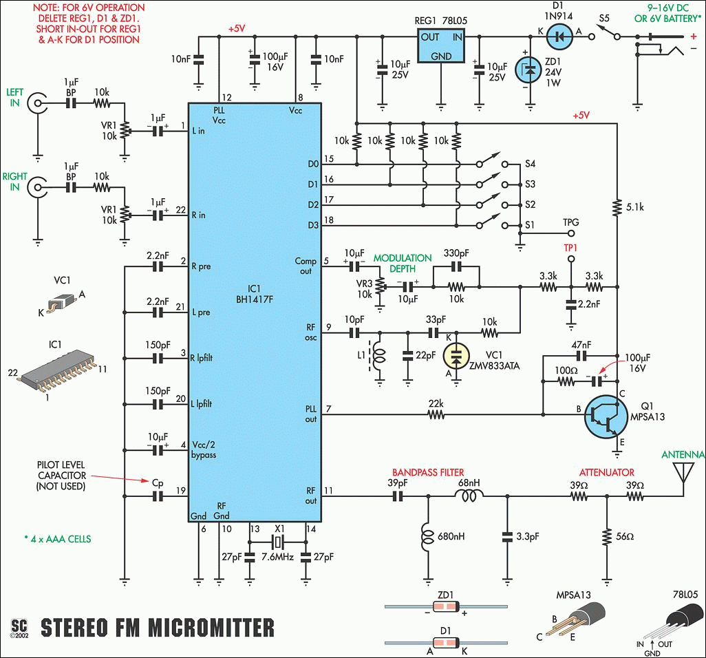

The Micromitter is a good quality FM stereo transmitter. Many are in stores. A guy replied that he bought one for $4.00 and I have seen them for $19.00.

on the Micromitter what are the 4 switches for and where is the frequency adjustment.

Very accurate FM radio frequencies are selected with the 4 switches in the Micromitter.The entire Micromitter project is here:
https://electronics-diy.com/schematics/BH1417_fm_transmitter.htm
