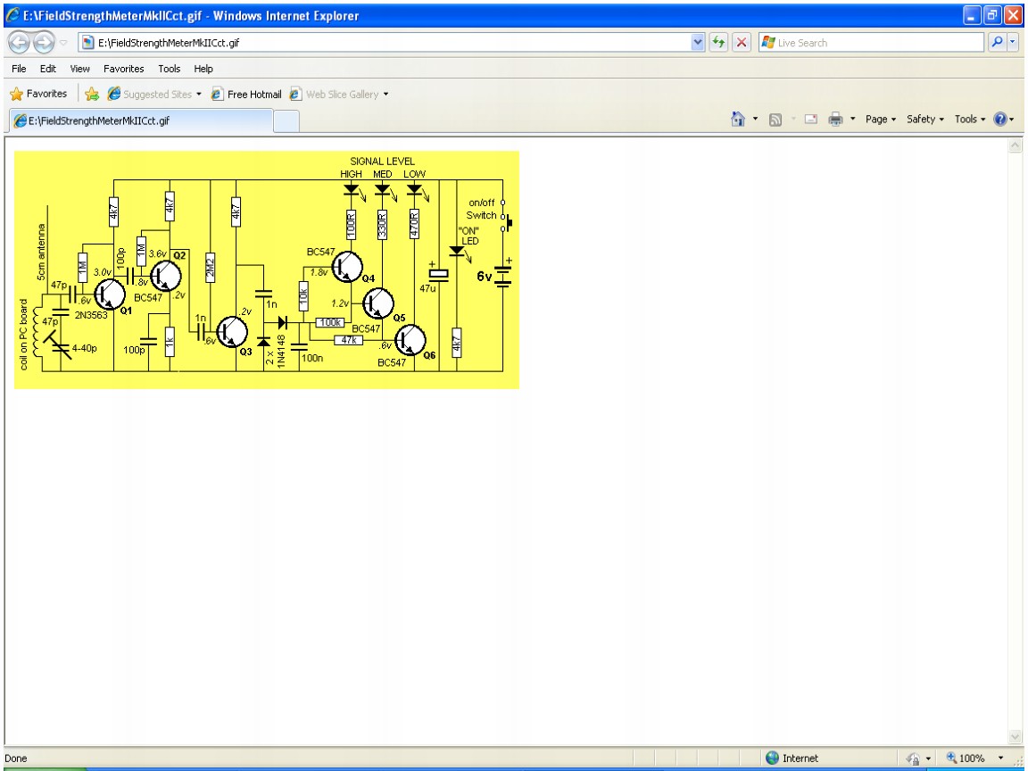

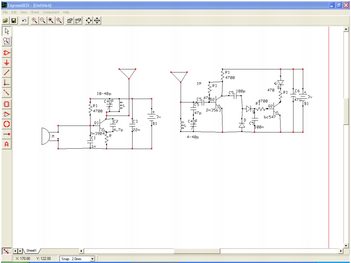

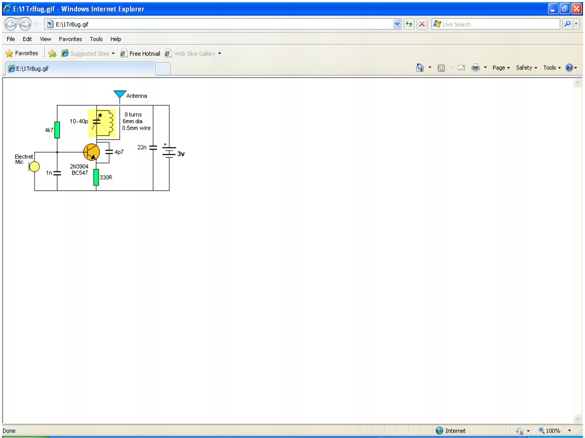

Found simple transmitter / receiver
simplestic transmitter ()only need 20-30 ft
the receiver is part of a field strength meter
don't know much of anything when it comes to RF but just maybe these will work??
