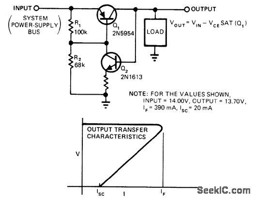

The circuit attached is of a foldback current limiter, what determines the 20mA at the low end of the current limiting, and is there a formula to calculate this.
Kind Regards
Paul

What is the emitter resistor of Q2 supposed to be?
I couldn't find either of the transistors in my LTSpice library, so I substituted ones that have similar specs, especially Hfe.
The circuit is very sensitive to the actual Hfe of Q1 (therefore, IMHO not a very good circuit).

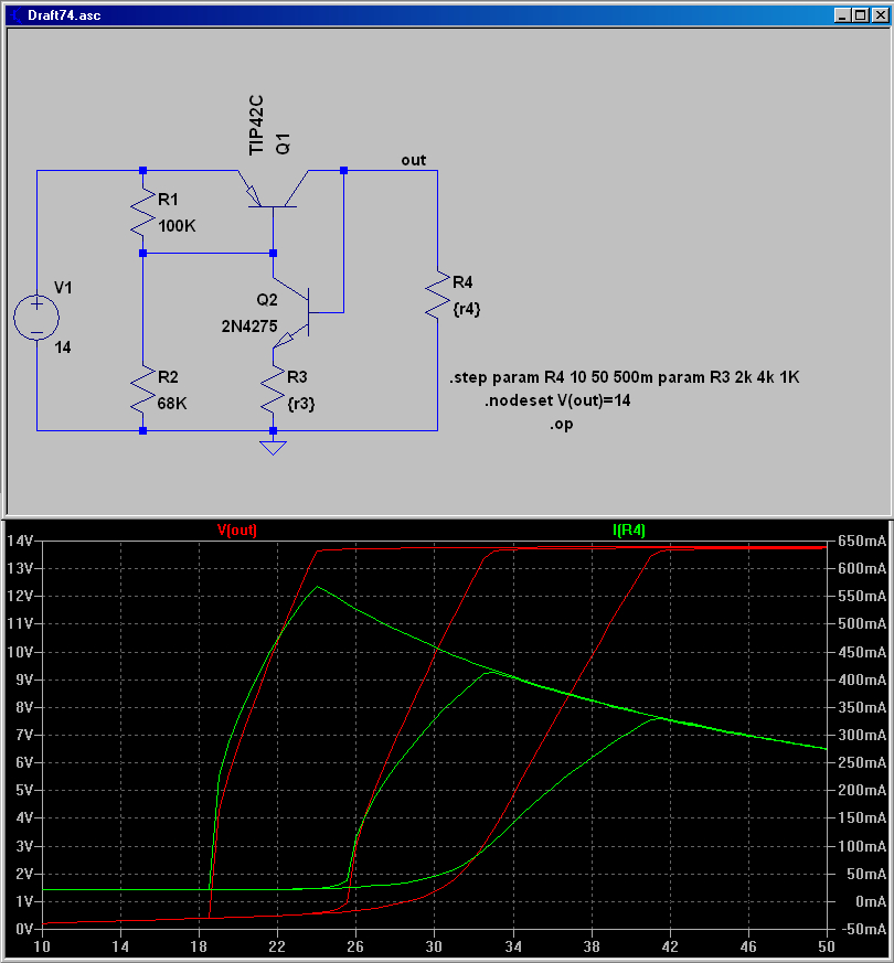

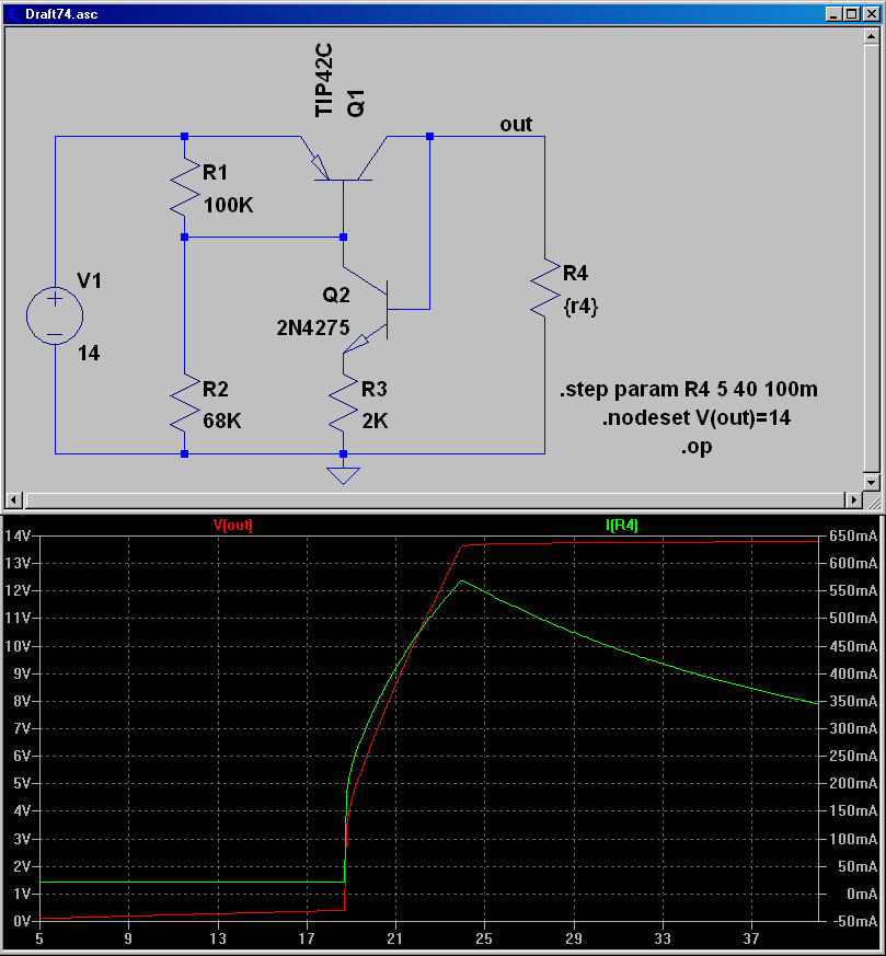

First figure shows the current limiting as a function of the load resistance, R4 with a WAG for R3. Red trace is the voltage output. Green trace is the current through R4. Note that for load resistance < 18.6Ω, the output current is ≈ constant at 20mA. For load resistance > 24Ω, the output current is inversely proportional to R4, so no current limiting there. Between those values, the fold-back is happening.
Second figure shows the effect of changing R3 from 2K to 3K to 4K (order: left to right). Note that R3 seems to effect the onset of current limiting, but doesn't effect the folded-back value of 20mA very much.

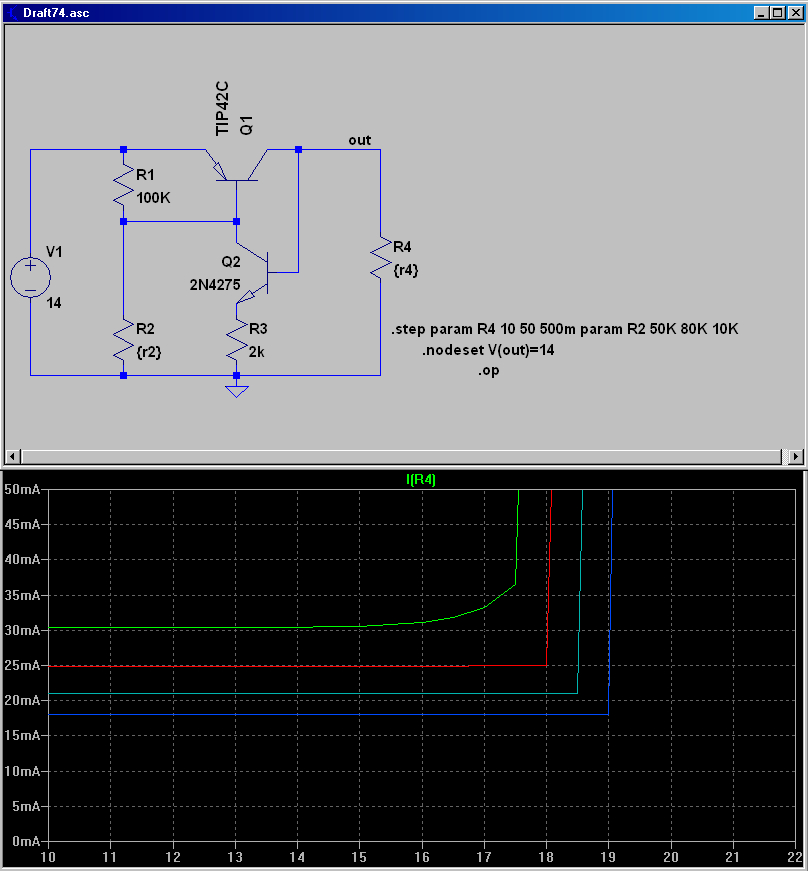

Third fig. shows the folded-back current as a function of Load resistance R4 while R2 is varied from 50K to 80K in steps of 10K (order: Green, red, lt. blue and dk. blue, respectively). The f.b. current is a function of how much base current flows out of Q1.
This should give you something to work with.

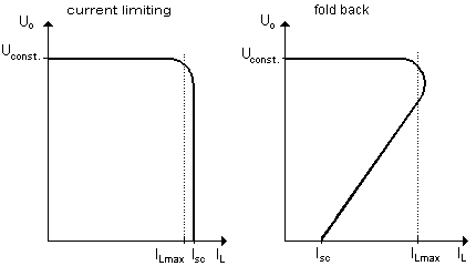

you could get a similar effect using a constant current source as the limiter. the output voltage would begin decreasing when the current limit is reached, but the current will remain constant at the set-current of the CS. this is sometimes confused with foldback limiting, but it's only the voltage which folds. the required power dissipation for the current source is higher than a true foldback limiter.
unclejed613 that sounds interesting, i never thought of it that way to be honest so this would be a voltage foldback circuit? so in a current foldback the current decreases but do the voltage remain the same?

Crustchow provided a good selection of web pages which show the many ways foldback current limiting can be implemented.
But as one of the app notes there warns, foldback limiting has some caveats:
" Linear foldback can have problems tripping current limit during start-up and returning to full load after a fault condition. These problems tend to lock up the Regulator in current limited state"
Therefore, if you implement a current foldback scheme, don't make it very aggressive...in other words, that the foldback is no less than 40 or 50% of the full rated current.
