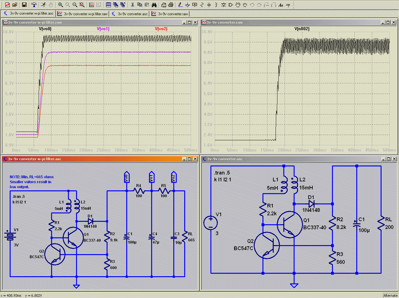

I'm currently playing around with one of our own Colin55's circuits. It's a simple but fascinating one, actually just the power supply to another project. It's a flyback step-up converter that uses 2 1.5V cells to produce 5 VDC. My idea is to tweak it to replace 9-volt "transistor" batteries for some of my own projects.
OK, so I got a simulation running in LTspice. There are some interesting quirks.
In the attached picture, the right-hand side is his "stock" circuit (but with the voltage divider values changed to produce 9 volts). Notice how jaggedy the voltage waveform is. This is something Colin points out in his description.
So I though I'd try to clean up the output with some filtering. Now, I know next to nothing about filter design, though I know basically how they work. So I played around with a pi-filter design in LTspice and came up with the other circuit. Notice the resulting waveforms, the last of which is much cleaner. Still some ripple, but no jagged spikes.
One thing about the "original" circuit behavior bothers me. What's up with that >160mS delay before the oscillator starts?
The other thing is that the whole thing depends on the size of the load resistor. By trial and error I found that for the pi-filter circuit, any value below 665Ω results in (practically) no output. I'm assuming this means that the maximum load for the circuit has been exceeded, which puts the maximum output at about 11mA (7.5V/665Ω). The "original" circuit fares a little better, at about 45mA.
My BC338 and 547s are coming with the UPS guy tomorrow, so I'll be able to test this out for real then. I really like the idea of this simple power supply; I hope the reality is somewhat close to that possibility.
Any ideas or suggestions appreciated.
LTspice sim files attached.

Where will the 3V input come from?
If the output is 45mA then the 3V will be 162mA and AA alkaline cells will drop to 2.4V in about 5 hours.
A lot depends on the size and type of material for the core.
Yes, I know. The transformers I've been winding are made from small reclaimed ferrite bobbins. Not sure exactly what kind of ferrite, but probably close to what's needed.
Next thing is to try to nail down the actual inductance, which of course has a big effect on circuit performance.
Put a small cap from B to E of Q1, that will slow doen the oscillation frequency a bit and probably improve efficiency. Then you can use less turns on the coils again increasing efficiency and reducing the amount of work to wind them... ;)
Well, I got the converter to work, which was pretty nice: after tweaking the voltage-divider resistors a little, I can get a solid 9 volts out of it, with two good AA cells.
But it's oh so weak. I used 590Ω as a load resistor; anything smaller and the output voltage sags badly. Use a couple not-so-fresh cells and it sinks. I'm going to try to characterize it a little better, keep a constant real load (a couple LEDs on it) and see how long the AAs last.
I wonder: what could be done to improve output, efficiency or both? From Colin's description, it seems pretty well optimized.

So what exactly would that do, Mr. RB? I tried a small cap, but it might've been too small. (47pF or so.) Will try a couple different ones.
If you are using your filter you can replace the Rs with some Ls and improve both output and efficiency.

All these things you are saying are basically untrue.
The circuit delivers 50mA at 5v with 30mV drop and 75mV P-P noise at 80kHz.
The 2k2 reduces the impact of the gain of the transistor enormously, so an extra-high-gain transistor is not going to be of any advantage.
The circuit has been especially designed “very lightly” so that it consumes very little current. At present, it consumes 5mA.
An extra 10u cap on the input is not going to improve matters. A 100u is perfectly sufficient across the battery. However in the original design, the circuit delivers 10-30mA @5v and an electro is not needed.
Changing the diode is not going to alter the output as a 1N4148 will handle over 70mA.
And saying you cannot get good efficiency from a single transistor is simply not correct. A single transistor works much better because it responds to the requirement of the transformer much better than delivering a long-duration square wave, that maybe over-saturating the core.
The circuit self-regulates as the input voltage changes.
You should build the circuit and try the things you are saying, before espousing your beliefs as facts.

I'm intrigued enough with this circuit to continue researching it (aka playing with it). I'm getting some interesting results.
One thing that would help me enormously, Colin, would be if you could give me the specs for the inductor core you used for a transformer. The version I got working used a medium-size ferrite bobbin (about 1/4" dia.) with many more turns of wire than you called for in your design (75:115). It works, but I wonder if it might not be optimal. I would really like to see just how many joules I can squeeze out of this power supply.
For what it's worth, I think it's quite an elegant design.
The inductor core was an old 10mH choke. It has a core of 1.6 to 2mm and a top and bottom of 7mm (0.3in) The wire is 0.25mm but the feedback can be any finer gauge. More than the specified number of turns reduces the output current capability.
So the results from the first round of testing at Carbonzit Laboratories, GmbH are in. I wound a new transformer (see below) and used two different loads for testing. Source were 2 somewhat worn-out AA cells.
Load 1: 4 super-bright white LEDs:
Vi: 2.3V
Ii: 110 mA
Pi: 250mW
Vo: 12.6V
Io: 11mA
Po: 140mW
Eff: 56%
Load2: 4 green not-so-bright LEDs:
Vi: 2.2V
Ii: 105 mA
Pi: 230mW
Vo: 8.2V
Io: 18mA
Po: 140mW
Eff: 60%
I don't really understand why the output voltage seems to track the load exactly. I used no current-limiting resistors on either set of LEDs; the output current just seems to naturally settle at the amount wanted by the LEDs (????).

Well, that being the case, I'd like to hear more from you. Given the current state of this experiment, what are your suggestions for improvment?
I should say that while I am after higher voltage (9 volts, perhaps even 12), I don't have too many unrealistic expectations so far as current goes. I'd be happy with 50-60 mA or so. Of course, more is better ...
And better regulation would be nice, if that's possible. At least as far as my version goes, it's nowhere as self-regulating as Colin claims for his (5 volt) version.
You can replace a 9v battery with this circuit.
The output is about 10.4v on no load and 9.6v @30mA output.
The advantage is the voltage stays over 9v for the life of the cells.
A normal 9v battery drops to 7v very quickly.
The output voltage is set to 9-10v by the 6k8 and 390R resistors. The 470R gives the circuit an idling current of about 20mA
