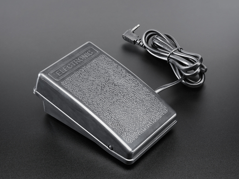

Still, the pedal could be inserted where the 7.5k resistor goes, along with suitable adjustment to the other components. I'm assuming the OP wants the speed to increase as the pedal is depressed.

But because it's not a pot, and indeed not just a variable resistor, it's not really suitable for what he's trying to do.
I suggest he buys a proper one:
Or how about getting the throttle pot from a modern car?.
Okay, so I looked at that foot pedal, and just wondering, do I put whatever size pot in there that I want?
It looks like it comes with a 20k installed...

It depends if you can change it or not - otherwise adapt the top resistor to compensate.
As I said previously, you need a resistor in series with the pot, which sets the maximum output voltage, and increasing the pot value decreases the output voltage. You could also add a resistor in parallel with the pot, to decrease it's maximum resistance.
What voltage range are you looking for?.
