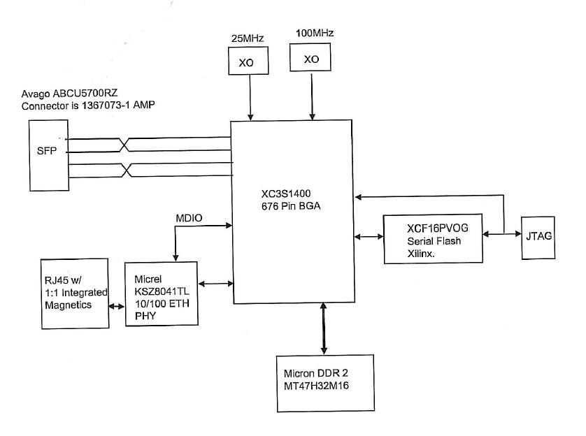

Hi All,
I"m working on my first real FPGA board and have a couple questions. Block level is attached.
1. How do you usually get all the pin assignments for the FPGA into a schematic capture tool? Is this really done manually?
2. Does anyone know where I can find information on how to connect up and FPGA for LVDS?
Regards,
-mike

The schematic capture symbol can be made and conneted manually like any other component. BUt yeah, it is a PITA to do with larger BGAs.
THere is software like FPGA System Planner can do it for you though to try and optimize routing based on a set of constraints (which signals can go to what types of pins). But it tends to only come with schematic capture software that costs money.

the likelihood of your being able to deal with a 600pin BGA is phenomenally miniscule. I design with FPGAs as part of my job and an ordered not touch one of those. You need to be able to be able to do at least a 6 layer PCB with buried vias and a grid of pads at 0.5mm or less pitch. You then need to place and solder the BGA when there is no way to get the heat to the pads to melt the solder with the only way to verify the soldering quality being an xray machine.
I can design the board, place and solder the BGA, but we can not justify the purchase of the xray nor desire the expense of sending all our boards out for the test.
You should concentrate on an FPGA that is NOT a BGA.

You're talking about in-house mounting of the BGAs right? Because if you pay to have it mounted and x-rayed I don't see how there's a problem (of course, $$$). I've been wrestling with the idea of dishing out a bunch of cash to have a some FPGA processing modules made. It's expensive for the 8-layer board and BGA mounting but the bigger problem is the risk involved. I estimated it would come in at $800 a board rather than $600 which is what it cost to buy a module that doesn't have exactly what I want.

Don't use a BGA package. Instead, use a TPFQ package with a smller part, like the XC3S50A. You can just hand soldier it.
