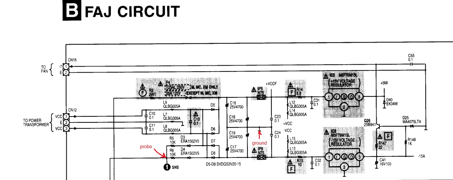

I have a technics keyboard, that when we plug in the only thing it shows it the LCD ilumination.
I made a few measures on power and initial PCB and find every VR are working and power is getting in main PCB.
In this main PCB there is a 32 bit microcontroller MN103002A.
The issue is, how can i make sure this microcontroller is working? Shall i measure VSS and VDD voltages? What is the diference betwenn these 2 voltages ( VSS vs VDD )?
I send in attach block diagram of all circuits ( if anyone have time to watch.. lol ).
Thanks a lot for any help or hint!!

SNS is at fault and will not power on RESET (POR) properly.
This pulls up R2 > Q2 > R4 > RST on p28
But I am not impressed it will hold down RST for a 100 us or so with a dependence on Q2 hFE with R2/R4=100 and an exponential rise. If RST ="1" the voltage must be > 2V.
Calibrate your 10:1 probe and find why you are not getting 4V on SNS There may be a storage cap. missing..
But be careful SNS comes from line voltage diode bridge that detects line input to pull the RST out of reset slowly then when 3.3V turns on RST goes high quickly by 0.22uF cap C3.

I can see that, this checkpoint, i have read with osciloscope, "SNS", goes to pin28 of CN1 ( FAJ BOARD ).
After that, this signal "SNS" goes to MAIN PCB (CN101) and gets the name "E", after that, i cant follow the circuit...
Scope SNS
Then if OK, Gnd RST carefully to compare the power On RST with this manual RST.

Q2 is a capacitor coupled emitter follower!
The Q1 circuit that feeds pin 147 appears to release reset during its positive pulse??
I'm guessing that whatever connects to R2, 100K, is supposed to switch high during the startup sequence?
It goes to the CPU /NMI pin and Pin G on the "Main 4/4" interconnect, signal "SNS".
On sheet 4/4 it just loops back out to CN 106 - which from the interconnect drawing, is not used - diagnostics??
Just found some more info - From page 40 of the manual, the SNS signal (feed to R2) should be at 4V while power is on.
That's what holds the /RES signal high via Q2.
I've not found what drives that yet, though..

On the other hand SNS on power FAJ board goes to pin28 of CN1 connector conecting to MAIN pcb CN101 that as i can understand goes nowhere.... :| (pag 37)
These tests are on FAJ pcb, and if everything is connected display doesnt show anything and
buttons dont even light on...
These tests 3 to 8 need to select a sound ( BRASS ) and thats not possible in this state... :(
The SNS test i made gave me this wave, instead of the one showed 4v pp flat...

B - FAJ BOARD
testpoint1 - 3.9volt (SNS) - SNS in osciloscope views in attach.
testpoint2 (PMUT) - 0volt - when powering off it goes up for 1 second to 3.3volt

The SNS signal is what feeds R2 in the reset circuit.
If SNS is at 4V, the base of Q2 should also be near 4V???
Is pin 141 on the CPU near 0V or near 3.3V?? One of your earlier posts said it was near 0V, I believe?
