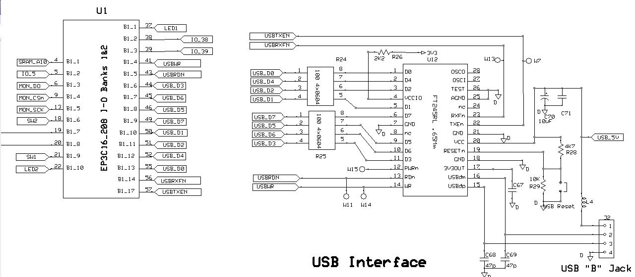

A good way to interface USB(i believe that's what you meant) to an FPGA is to either:
COPY the circuit from a development board schematic
BUY a development board.
That said, here' s a fragment of a schematic of an Altera EP3C25 connected to an FTDI USB-chip.
.. this was used to down-/upload data to to a test-jig at 8MBytes/sec with a simple program that addressed it as a serial-port.
There will be a learning process for either X or A: best to choose based on what your fellow-students and instructors are doing.
Use caution if choosing a development board. My Spartan board has a USB connector, BUT it's dedicated to that JTAG programming resources, and AFAIK, cannot be used for general USB communications.
If you want USB capability "out of the shelf" look at the DLP-USB245M USB FIFO module (which uses an FTDI chip). It has a very user friendly parallel interface. I use one in one of my projects and I control it via a Xilinx CPLD (ancestor of FPGA !!).
