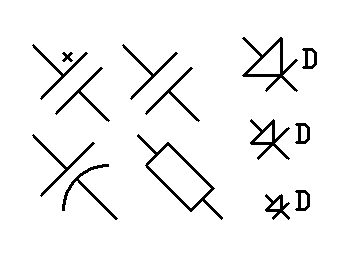

I haven't found a free cad program yet that can rotate a component 45 degree's though... ticks me off cause I don't like drawing diode bridges as squares.

I use ExpressPCB for schematics. It doesn't rotate components other than at 90 degree stops, but the components are easy to create. I've made some 45 degree components as needed. These than be rotated at 90 degree intervals. I haven't done a 45 degree zig-zag resistor, but haven't really tried.
Ken

you can draw 45 degree symbols for LTSpice and use them, but i'm not sure yet how to link them properly to the device selector, so i can for instance change a bridge of 1N4004s to MUR820s. so far i have to make a separate symbol for each diode type....
