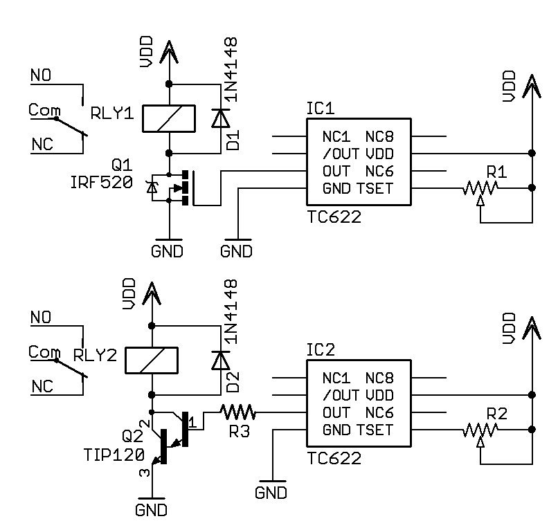

a newbie here - want to limit the run time of a standby generator utilizing freezer temperature. Have a Microchip TC622EAT sensor that works great on the breadboard. Can set the critical temperature with resistance. It flip/flops the 12 vdc from high output to a low output when critical trigger temperature is reached. However, I need to operate a 12 vdc relay that can handle 10 amps. The one I have draws 75 ma and the sensor max is 600 microamps. So, I screwed up the sensor output - only puts out 4 vdc which obviously won't trigger the relay coil. (I have a couple more sensors to play with)
The relay is NO, closed utilizing high out from sensor until temperature reaches trigger point and the 12 vdc flips.
The idea is if there is a prolonged power outage and I am out of town, the generator would run 24/7 and run the propane tank dry. If it only ran when the freezer needed it, it would conserve massive amounts of fuel.
Any and all suggestions appreciated. Thanks

here's 2 circuits I worked up, one using a mosfet, one using a darlington. I've not tested either but they should be ok.
the base resistor for the darlington should be enough to limit the current to 500 uA. I'd start with 20K or so. I'm not sure what you do with the relay output, though. the pot is to adjust your temperature setpoint. You will probably have to do this out of circuit. see the datasheet for details.
finally, how are you expecting to power this circuit? battery?
edit: answering your questions. the 2N6426 or BC618 would work ok. I don't know what you'd use the 555 for in this case.

note that the darlington will have a several volt drop so your relay will see something on the order of 10V. This is probably ok but check the relay datasheet for it's "must operate" or "pull-in" voltage.
With the MOSFET circuit, I want to verify I am reading the schematic correctly for the IRF520. S goes to GND, G goes to sensor output and D goes to one side of relay coil.
With the Darlington circuit, I connected 3(E) to GND, 1 (B) to the sensor output with 20K resistance in series and 2 (C) to one side of the relay coil but I am not getting any voltage out of Pin #2. Not sure if I did something wrong or if the 20K is too much resistance taking the sensor output too low?
first, please make sure that the pin numbers for the darlington you are using are the same as the schematic, if not, make the changes. [I knew I should have found a darlington symbol that didn't have pin numbers.] then, once you have it wired as shown (ignoring the pin numbers), between C and E, you should see close to the full voltage when the device is off (sensor output low) and around 2ish V when the sensour output is high. Assuming that C is connected to +12V through the relay coil. Check the base voltage, also. it should be around 9-10V when the sensor output is high. For testing purposes, you could live with the damaged sensor output of 4V, by the way.
what darlington did you get? by the way?
I was able to get the TIP120 Darlington but could only get a IRF510 MOSFET rather than the IRF520 you showed.
For the Darlington, I got 1=B,2=C and 3=E off the data sheet.
Check the prior message about the MOSFET connections.

IRF510 is fine. The only difference between IRF520 is that the 510 handles 5A between source-drain and 520 can handle 10A. Your relay coil current is nowhere near that much, only 75mA, so it's all good.
You say you can't get enough current? Did you make the proper connections?
Sensor output goes to ground (I am assuming the sensor output is >4V below critical temperature and <2V above critical temperature, is this correct?)
+12V ->+ relay coil
-relay coil->MOFSET drain
MOSFET source->GND
Can you connect an ammeter in series with the relay coil (or anything else along that line) to measure the current that is flowing through the MOSFET source-drain and relay coils when you apply 12V to the gate of the MOSFET? What is the current being measured?
Just something I am wondering...don't fridges "shut off" when it's cool enough and only turn on when it gets too warm? Like when your fridge humms after you have left the door open for too long and then stops humming after the door has been closed for long enough...
I wouldn't waste such a large MOSFET on powering such a small relay, I'd use something smaller like a 2N7000.
Don't forget to put a diode in reverse parallel with the relay and as 10A is quite a high current I'd also strongly recommend adding a reisitor the same value as the coil in series with the diode.
It's best to debug one circuit at a time. darlington - make sure you have the parts wired up the way the schematic shows. Measure with the the common lead of your dmm connected to ground. Then, with the sensor output not connected and r3 connected to gnd, starting at the top, measure the following:
  • +12 rail - should be, well, +12.
  • top of relay coil. should be +12
  • bottom of relay coil. should be +12 or slighly less
  • top (collector) of tip120. should be +12 or slightly less
  • bottom (emitter) of tip120. should be 0
Now, connect r3 to +12V. you should see the relay activate. the above reading will be the same except bottom of realy and collector should read around 2V.
If that works, lets look at the sensor. read the output voltage when its triggered - it should be around 10V (> .8*12). I've got friends here so I'll be offline for a while. good luck.
