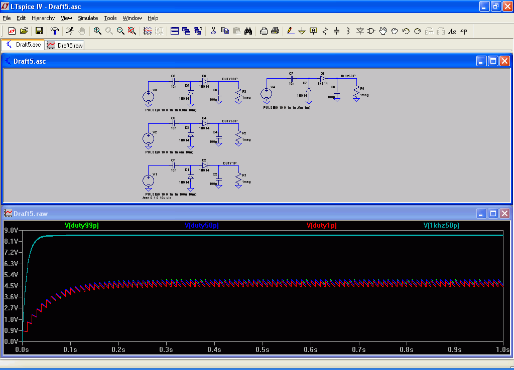

Sorry, the transfer cap charges and discharges quickly.
Attached cct shows 1% 50% 99% 100Hz charge pump outputs. A 50% 1kHz is there also. The levels are quite similar, even with the varying duty cycle.
QUOTE]Sorry, the transfer cap charges and discharges quickly[/QUOTE] Agree..I was referring to the output cap where you actually take an output.
As I said the devil's in the details. With an output RC time constant of 100mS for 100Hz, I wouldn't expect to see much difference. Try it with an output RC combination with a time constant of something between 1 and 10 mS...10K to 100K load. Just curious.

QUOTE]As I said the devil's in the details. With an output RC time constant of 100mS for 100Hz, I wouldn't expect to see much difference. Try it with an output RC combination with a time constant of something between 1 and 10 mS...10K to 100K load. Just curious.
Well the devil's a pedantic little .... ;)
As for reducing the time constant, obviously the output ripple increases (greatly). You could low-pass filter that signal I guess to get something more usable.
Yes, and that's that concept to make a tachometer with a fixed pulse width, variable frequency signal.
