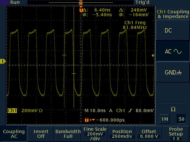

I was mistaken about the characteristics of the input signal I'm trying to divide. It is, in fact, a square wave with a period of about 12 ns (6ns high, 6 ns low with rise/fall times :ltoet: 1 ns). The amplitude is 1 V. I'll attach a scope screenshot since I'm having some trouble uploading to the web from work.
Probe setup at 1x, 4div@200mV/div.
That was small signal, right?

Looks like he had the input impedance set for 50 ohms, which loads the crap out of the signal. I would switch probe impedance to 1Meg and try again. Scope input capacitance might then be a problem, however.
Yeah, its the scope capacitance--I've noticed this before. Not too worried about it in this case, but thanks.

My point was, your signal amplitude is probably much higher than the ~1V p-p shown in the scope photo. It is probably TTL levels, as you originally stated.

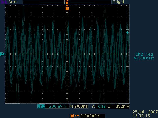

I've been working on this on-and-off, and I've learned a lot, but now I'm stuck again.
My current setup has an amp (MiniCircuits ZHL-1000VH) to bring the 800 mV p-p input up to TTL levels. Then I synchronously divide the 80 MHz to 20 MHz using 2 JK flip-flops (74F107). Next I connect to a 4 bit counter programmed to divide by 10 (74F163). This gets me the desired divide-by-40 circuit, and it multiplies the period by 8 times (also desired).
The attachment shows the divider input in yellow, output in blue.
My current problem is cleaning up the output. I'm particularly bothered by the noise on the top of the HI signal. For this I've tried using a comparator (LM361) with a Vref around 1.2V, but the output looks the same.
Other ideas I had are (1) filtering (2) locking to a PLL to produce a clean signal, or using a PLL divider like ADF4007 (3) using a different amp or a fast comparator for the input signal, since the divider works fine when I drive it with a function generator.
Any suggestions are greatly appreciated.

If channel 2 is the output of the 74F163, then the culprit could be that you do not have adequate supply bypassing on the TTL IC's. This would explain why the output of the comparator is not any better also. Do you have a 0.1uF cap across each of the 74Fxxx chips?
The other issue is that you are still using the 50:eek:hm: input on your scopes channel 2! Also, for fast rise signals it is generally better to use a X10 probe because these have less capacitance and better frequency response.

I have limited electronics experience, but I assume that when you say "supply bypassing" that means I should run those capacitors between V+ and GND before each of the ICs. Previously I had only one 1 nF cap in there, but I put in two .1 uF caps, one before each IC. This actually didn't change the output at all. More surprisingly when I looked at the supply line there was definitely some 80 MHz pickup (regardless of the .1 uF caps) [see attachement]. Some of this was just from the probe, but a substantial amount remained.
I'm starting to think that the pickup might be the biggest issue I'm facing. Even if I monitor other circuits on the same breadboard that are independent of the rf signal they show appreciable pickup.
Regarding the 50 :eek:hm: probes, those channels were measured using test clamps attached to RG-58 coax, which I thought was fine. The other channel was measured with a standard 1 M:eek:hm:, 10x probe. I found a second 10x probe, so I'll just use these in the future. The screenshot I posted earlier looks essentially the same except that the edges of the tall peaks are a little more square.
I mean as close as possible to the V+ and GND pins of each chip.
Breadboards are really bad for high frequency circuits because of the high inductance of the connections and high capacitance between them. Not to mention the lack of a ground plane. This is most likely the source of your problem.
One way to reduce pickup via the ground connection on a probe is to use a.... I forget the name of it, but basically it is a short connection from the ground ring at the probe tip to the ground on the circuit under test. It looks like a tightly wound spring with the end of the coil unfurled and sharpened for good contact. The "coil" part slips over the ground ring at the probe tip thus making contact to the probe. The idea is to use as short of a ground connection as possible.
