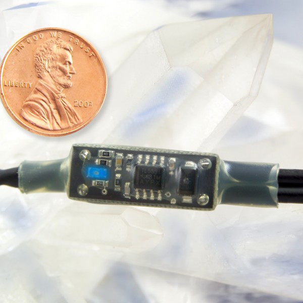

Hi people.. Joined this site to try to find a cheap way of making a very small square wave frequency generator to be run from a 9 v battery or 9-12 v wall plug. The above link is the part I am proposing to use. What I need to know is will this little device give a reliable 15 hz wave? Do I need to purchase another device to tune it? Programme on laptop..maybe! Is it truly variable? I would need to buy a 9 v lead from battery and also how do i get a lead out with alligator clips on it to transmit the frequency through a quartz crystal. Powered Orgonite project. Any help with this project will be greatly appreciated. I plan on doing a bulk order to save cash and then sell on to others experimenting in this area so we do not have to buy expensive complete items. I would then plan on getting some clear Heat Shrink to place around the device if recommended! Photo of desired outcome is attached

Is the attached photo the module in question? If so, it is simply a 555 timer with a cap and trimmer pot.
You'll need a scope or at the very least a frequency counter to adjust the trimmer pot to the correct frequency. As far as being a "reliable" 15Hz square generator, "reliable" is a relative term. What are the required specifications? Or at the very least what is the specific application of the device?

Hi bigdog ... I would like a small device to pulse a 15hz (or other frequencies) through a copper cable to a copper ring around a 150g quarts crystal. Its hippy stuff but the frequency is important and will run from a 9 v battery or wall plug.

Then I would say a 555 timer is more that adequate for the task. If cost is important - a 555 timer, capacitor and resistor/trimmer pot can be purchased for less than 50 cents USD.

The copper ring will have a very low resistance and will effectively short-circuit the oscillator output.:(
A low resistance will draw a lot of current and flatten the battery in next to no time.:(

Haha.... I thought I fixed the link... It works for me... but here is a much better photo of the device I am trying to replicate without paying $25 US plus postage. It is a standard 15 hz... 9v battery in and alligator clip/s out. I hope that gives you all a better idea of what I want. If it is a little bigger and variable... great. But 15 hz would be a great start for me /us... Cheers

Do you have good soldering skills? Surface-mount components, as shown in that product, are tiny. Adding a frequency control would add some bulk.
People selling cheap Chinese junk on Aliexpress know nothing about electronics so they do not say what frequencies the 555 module will produce.
The 555 module will not drive a copper ring.

Since we are talking about orgone here it may be more appropriate to use a starship coil rather than a simple copper loop. It would at least make a more efficient load for the 555's output transistor, although you'd still need a series resistance so it doesn't drag the output down completely. Also I have read they produce a relatively focussed magnetic field, which may be advantageous for your purpose.
Oh, since you ask, the leads with aligator clips go to output and gnd. You can buy leads with the clips pre-attached, probably cheaper than buying just the clips and making the leads! One of the leads has to share the gnd pin with battery (-). Vcc is battery (+)
If building your own, you may be better using through hole components and a bit of perforated board. MUCH easier!
