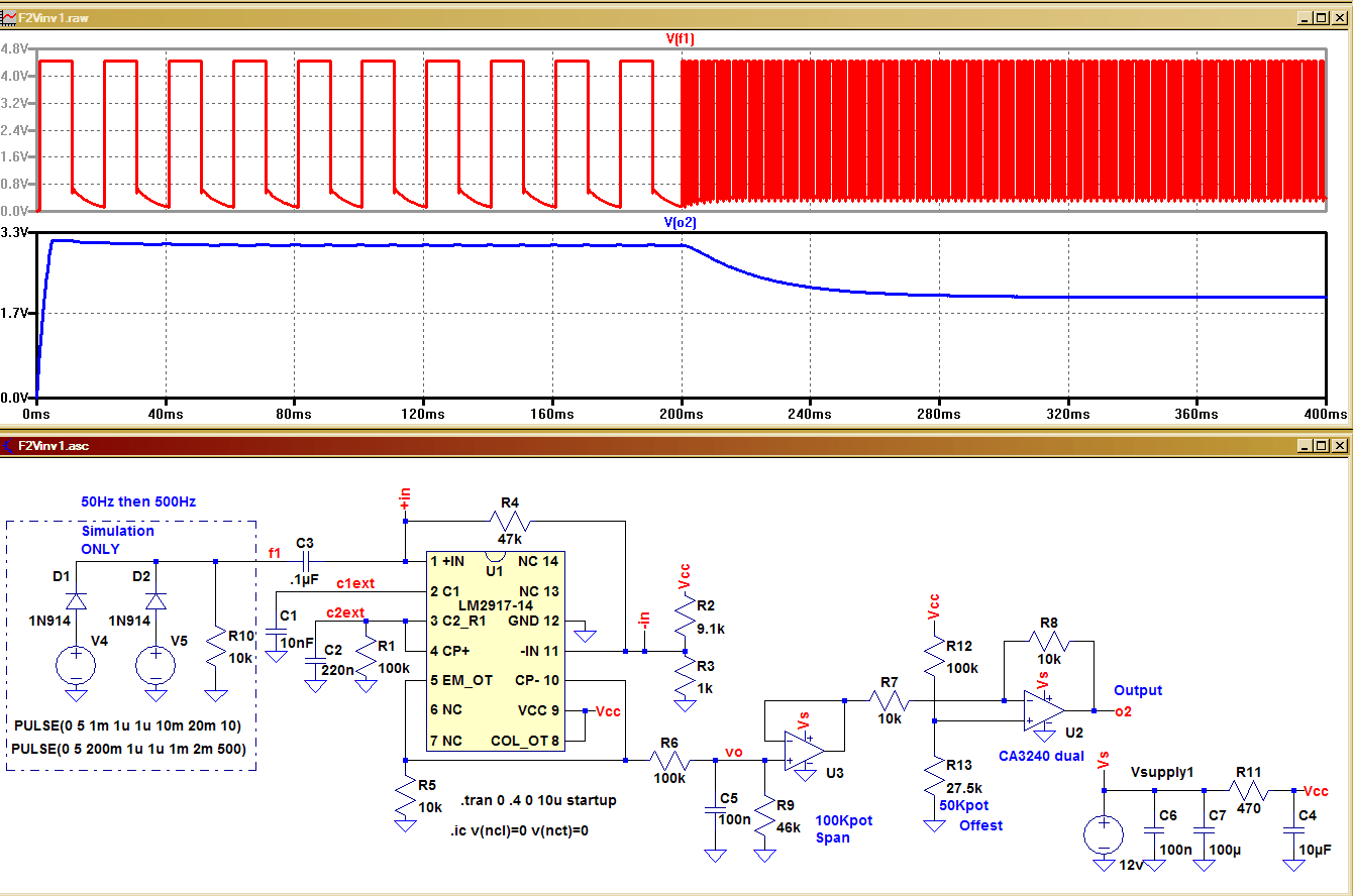

Hi all,
pls help me to design a frequency to voltage converter with low frequency give high analog voltage and high frequency give low analog voltage.
e.g A 50Hz-1KHz sqare wave will output of 3V to 2V.
How about an LM2907 or an LM2917? The data sheet should tell you all you need to know.
Freq->volt converter (LM2907), test for voltage at both freq limits. Use resistor divider and/or an opamp to rescale to range desired. Use another opamp as inverter. It's the rescaling where you have to get "creative"... <<<)))

pls give me some circuit ref for following parameters
f->v converter gives 2V to 3V at input of 50hz to 500hz. then using an opamp inverter i ve to make this 3V to 2V. my basic concern how to make a inversion.
whether it is possible in a f->v converter who gives descending voltage o/p with ascending frequency input or i ve to use another inversion ckt.
pls suggest some ckt.

Look at this option, uses a LM2917 and dual CD3240 OPA, powered from a single 12Vdc supply.
50Hz in = 3Vdc out,,, 500Hz in = 2Vdc out.
Span and Offset pot adjustment.

Thats an AC coupled OPA circuit.
Oops. That will teach me not to copy links without checking the target! :)
But I wasn't suggesting the F2V bit could be done with only one op-amp; just the processing of the V output.

Attached is the asc file, if you want to play.
The LM2907/17 is at YLTS group page.

Thanks, Eric. And there's me thinking you'd be playing with configuring the LM331 for this!
many thanks ericgibbs. you ve given exactly what i want. I implemented the ckt and working well.
