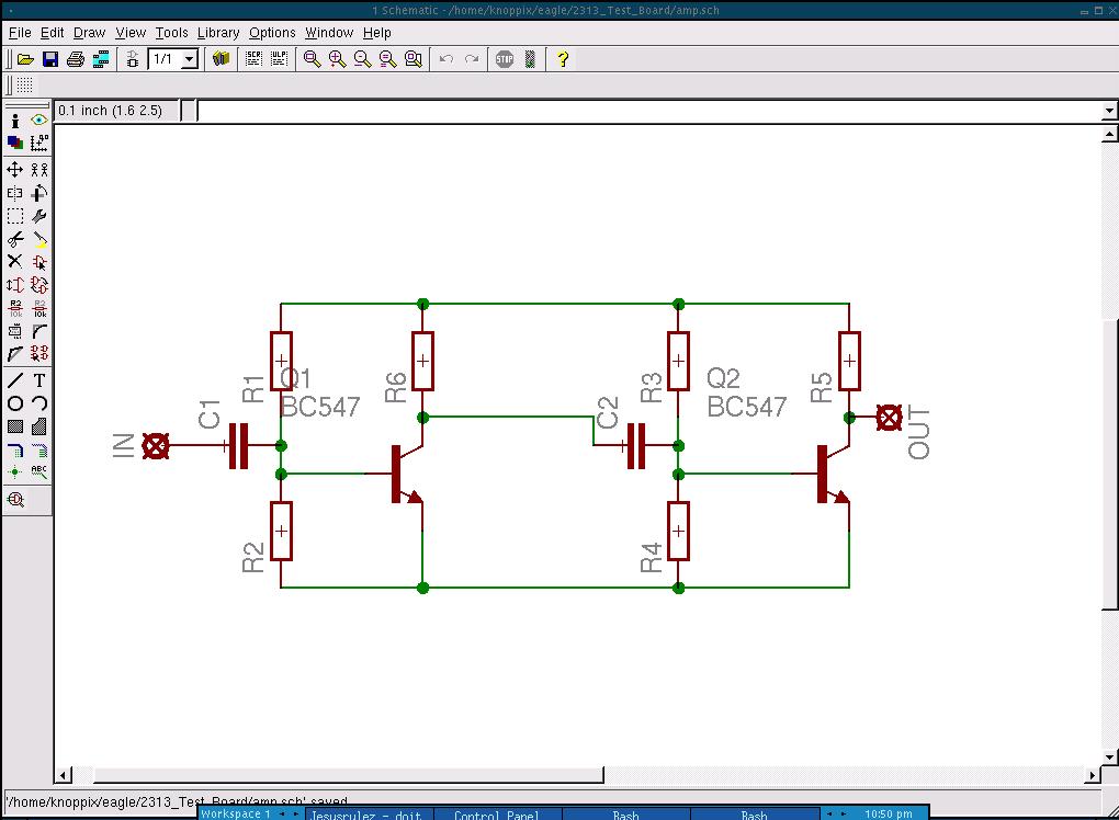

here is the schematic of my new amplification design. is this right, or did I understand you wrong?
PS: i forgot the power and GND, Power is connected to the top part, GND to the bottom...

Yes, that's looking OK - as already suggested, you may have too much gain now - you can reduce it (if required) by fitting a resistor in the emitter of the first transistor.
No you did not misunderstand me - except that you did not include the emitter resistor (between the emitter of Q1 and gnd) in the first stage (call it R7)
R1 = 220k, R2 = 56k, R7 = 470R will make the gain of the first stage about 10.
R7 will both reduce the gain and increase the input resistance - both are desirable.
Len
jesusfreak said:
do i need a capacitor at the output of this circuit, too? somebody said i should use one.
No, provided that the PIC and the amp share the same voltage supply.
