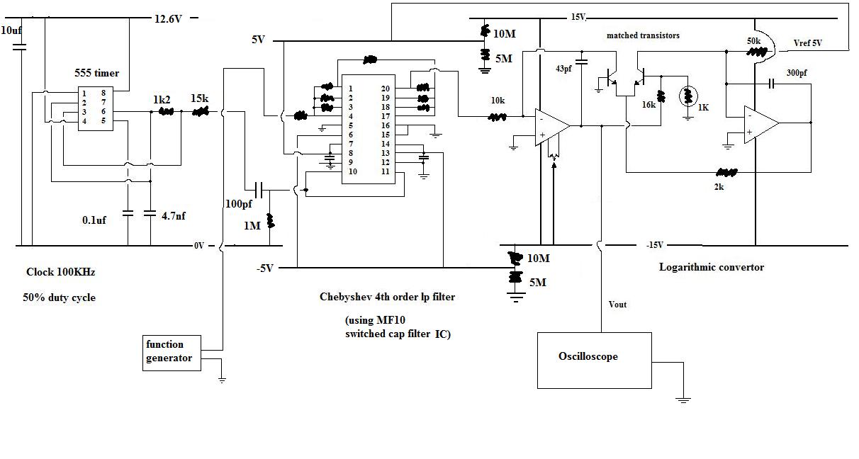

I've attached my circuit design, this is just my 2nd attempt to fudge different circuit parts together to form a working complete circuit so i expect i've made some mistakes. Hopefully someone could check it over for me please.
I'm afraid i don't understand the connections required from the oscilloscope to get frequency vs voltage displayed, does it require x-y mode?
My circuit is a 555 astable producing 100Khz square wave, this is required by the MF10 switched capacitor IC.
The 12.6V is required to give 5V + and - 5V square wave output from 555.
I havn't bothered including MF10's components values as this is specific to the filters qualities.
The logarithmic convertor is taken from a textbook.
All critiscm welcome, thanks for all your help guys
--circuit attached-- plz excuse paint i havnt worked out ltspice yet

The last circuit you posted is for the vertical channel of the 'scope for it to display the amplitude.
Now you need a logarithmic ramp for the horizontal channel of the 'scope and to drive a voltage controlled oscillator that feeds the other circuit.
I have done something like this before using the X ramp output on the back of scopes. I doubt the pico scope has that feature but your analog scope might.
But I think I agree with NIgel. Good old fashion paper and take data points.
i've downloaded the latest software from picoscope (1st time for a year) and i think it now has the x-y operation :)
