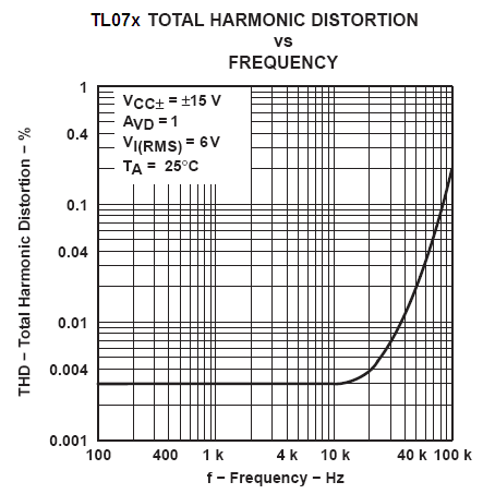

Most audio amplifiers have a very high gain and use negative feedback to reduce the gain and distortion. Since each stage in an amplifier has phase-shift, the amplifier's high frequency response is reduced to avoid oscillation. With the highs reduced, also the negative feedback at high frequencies is reduced resulting in higher distortion at high frequencies.
Here's the distortion vs frequency for a TL07x opamp:
