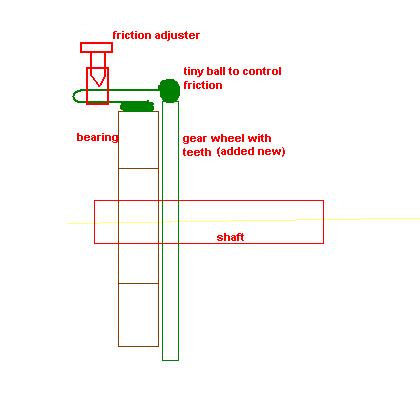

what about some arrangement as shown?

may be my understanding of your discription was wrong, what i mentioned on the diagram is a short of ratchet for with the gear is used.
Oh, you're talking about a ratchet device rather than a friction clutch. I'm avoiding ratchet devices so you can have very fine control (which is preferred when using the lever for collective control to hover a helicopter.)

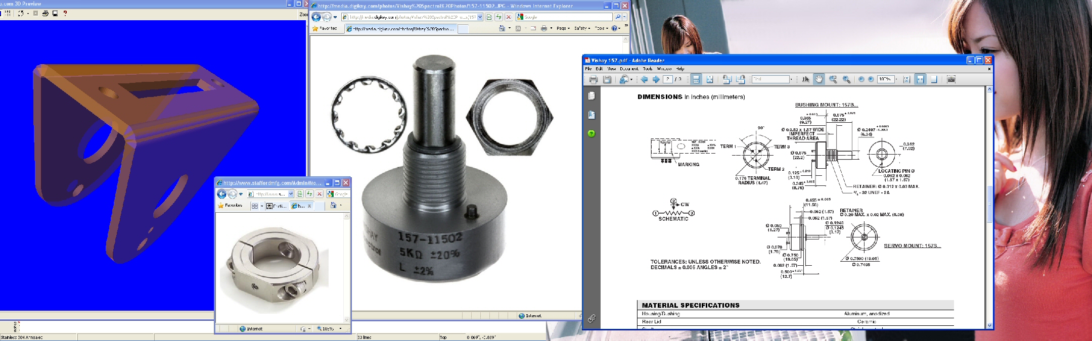

RIght now it's looking like this support bracket fitted with that displayed potentiometer. If I can get the displayed shaft collar customed (and the company apparently does custom parts and mods with no minimum order...but how much is something they have to get back to me about) so the dimensions are a bit different, it can clamp around the shaft collar and the threaded rod can screw in as the lever. I got some aftermarket RC transmitter gimbal stick ends that can screw onto the threaded rod to give me real handles. Right now, I can accomodate the cost of the bracket. But the cost of the the collar is going to put me overbudget. I don't know how much it is yet though...I'd be thrilled if I could get it for $15 a collar which is super unlikely.

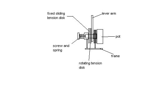

Hi dknguyen,
An easy way to make a friction disk for a lever actuated pot arm is
  1. make the lever arm which will go on the inner part of the pot shaft
  2. make a disk that is a pressfit on the shaft and put some rubber/leather on the face.
  3. make a sliding disk that will slide on the pot shaft that is spring loaded and adjustable then a bolt/set screw can be used for the tension.
This would be the easiest and strongest way and with having adjustable tension you could set it to overcome any vibration. Below is a paint mockup of what I mean.

Oh i see. I don't have enough room for that on the tip of the pot shaft for something like that since the shaft isn't long enough to make it far enough past the sidewall. But I do have plenty of room on the otherside of the shaft at the root - the mounting threads for the potentiometer are much longer than the sidewall is thick so there's an extra 5-6mm of screw thread there where I mount the lever onto. I can flip your assembly around (minus tension screw) to the other end of the pot shaft. I can place spring washers or springs over that unused threaded area so that they push off of the sidewall that the pot face is mounted to to force a piece of friction material against the lever arm (or rather, the shaft collar the lever arm is mounted to). No variable tension screw adjustment, but if I use washers I can cram more into there until I get the force I want.
Or a slight mod could turn it into a tension adjustment nut instead of a tension adjustment screw. 3/8-32 nuts are a strange thread size though.
What ever you do, you have to watch putting too much spring pressure on the pot shaft. If you load it too much you risk breaking the resistance disk in side the pot, or wearing it too much.
