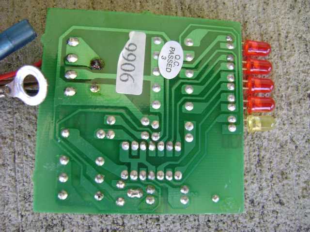

Attached is a zip file containing some pics of a small PCB. This PCB is out of a 12V / 24V starter pack. The 12V option works whereas the 24V does not work. As you can see by the pics there is a small fried component (next to the two brown wires.) I was wondering if anybody could tell me what this component is and what it's rating is so that I may replace it and get the 24V option working again. If anybody could offer any relevant information I would greatly appreciate it. Thanks.

It looks like a 3 amp power diode. (But it could be a 12v zener diode.) Let us know where the wires "go to" on the switch and where the other wires (leads) go to.
Remove the burnt out component and look at the symbol on the board.
I think it's a diode. You could use the 1N400x series.
1N4005, 1N4006, or 1N4007 if I'm correct.
Not sure about this because it looks like it would be across the voltage source, the red and black wires.

I am rather sure its a zener diode. It looks like a V1 reference below it. That is a common referance in century equipment to a voltage regulator device.

So go with colin's 3 amp guestimate and buy a 4-5 amp zener (cause obviously this one couldn't take it) Determining the voltage could be tricky if you don't know what voltage was on the circuit before.

I'm horrible and translating PC board views into schematics, though I try =\ If it's a zener regulator though where's the resistor? I'm not sure what I'm missing here.
I am just guessing that its a zener by the V1 referance. The resistor could be external to the board and the two brown wires may go to it. Its only a guess. It could very well not be a zener too.
could be reverse polarity protection. supposed to blow the fuse if you hook it up backwards. if you bypass the fuse, and hook it up backwards again, the diode shorts. if you keep it connected long enough to burn the diode open, you now have bigger problems. the diode used most often for reverse polarity protection is a 1N4004. the cathode stripe goes toward the positive lead.
We neeed to know the wiring to the leads and switch before we can decide anything.
It could be a zener to convert 24v to 12v, so the same circuit can be used as for the 12v detection.
Thanks all for your input!
Neglected to mention that the diode was blown by mistakingly connecting newly bought batteries incorrectly.
Given this, is using a 1N4004 a safe option ?
