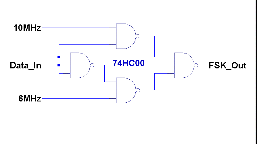

i need help to build a fsk transmitter....i m using 10Mhz for logical 1 and 6mHz for logical 0... i want to build a system that can transmite binary ..any one has any design or hint for me is welcome

sorry i forgot to mention that its a school project, i m allowed to use theses frequency becuz the range between my transmitter and my receiver is not more than 10 meter... i have to build from scratch with out using chips or any device
well my main probleme is that i donno how to combine those 2 frequency in one signal depanding if its a logical 1 or 0 ...that will goto the antenna
i m building a system that will send binary (ASCII) to an other device
i've tryed to use analog switch SPST and SPDT...both didnt give the effect i needed.

My main concern if the frequency shift you are suggesting, from 10MHz to 6MHz is crazy!. In FSK you would normally shift a very small amount, perhaps 1KHz or so - why are you suggesting such a huge shift?.
Radio amateurs, among others, have used FSK for years. As previously mentioned the amount of shift is usually small but I suppose that doesn't mean that you can't do what you propose (with due regard for the law and interference). You might look for ideas in amateur radio publications.
You can do the FSK with a simple data selector if you have the two frequencies and the data available as logic levels. See below.

i gotta admit thats a good idea...i dont understand how i didnt thought of that before

While Ron's dircuit would indeed produce the results you desire, it would be non phase coherent FSK. Also, to have a receiver with a bandwidth of 6MHz to 10MHz is not easy, if not downright impossible. You would need two receivers, and then synchronize the two output streams to give you the required data. Both receivers would have to have some form of squelch circuit to cut one off during periods when the other is transmitting. A typical FSK, as mentioned before, have frequencies that are fairly close together.
I'm no communications expert, but why would you even want phase coherence with FSK, unless perhaps the data rate were a significant percentage of the carrier frequencies? While I agree that trying to transmit and receive this (6MHz/10MHz) by conventional radio techniques is difficult, it could easily modulate a solid state laser and be transmitted over a considerable distance and still be received and demodulated. I'm not defending the choice of carrier frequencies - just pointing out that, under some circumstances, they will work. I agree that the frequency deviation should be a small percentage of the carrier frequency if RF techniques are to be used.
Regarding the need for squelch mentioned above - over short distances, where good S/N is available, AGC would be unnecessary (most homemade, short range receivers don't have AGC). Without AGC, why would squelch be necessary?
ya i tought about it while busy with nature...lol...and realise that indeed it will have probleme with it becuz out of the AND gates the signal are TTL level...therefore i will only get the positive half of the oscilator...I m thiking maybe with a summing op-amp will do the job....
i m not very good in telecom stuff...but just wondering whats a AGC and squelch...
U mentioned that the frequency of the carrier should have a ratio with the data rate....well i m not sure yet ..its either 19200bps or 9600bps... and also i m not sure yet if i should use the TTL level for the data or the RS-232 bipolar data(-9 to +9)...
There are good reasons for phase coherence in FSK, especially if a PLL is going to be used for the decoding. Without phase coherence, as in the case above, the system is no better than OOK. In other words, why bother to use 10 MHz, and 6MHz? One could simply transmit 10MHz for logical 1, and nothing for logical 0 (OOK). Also, even in that kind of system, one would need something to "mute" the output when nothing (no 10 MHz signal) is being received; otherwise, the data slicer would have a hard time following the 1 - 0 transitions.

i figure out how to make it work with the SPDT (DG403)...for some reason it doesnt work with high frquecy oscilator...the data sheet only talks about the clock and more detail bout it...but not the frequency of the inputs...anyway i got it to work with smaller frquency
Yes i do really need 2 diferent frequency cuz if logical 0 is represented by no frequency and if i have nothing to send is also no frequency...if my fisrt data bit is 0 ...then i m screwd the data
