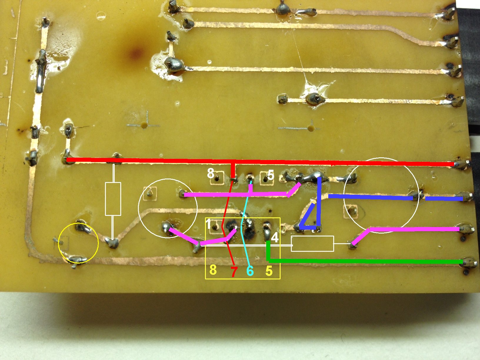

If possible post a clear picture of the pcb, front and back, we can check your wiring.

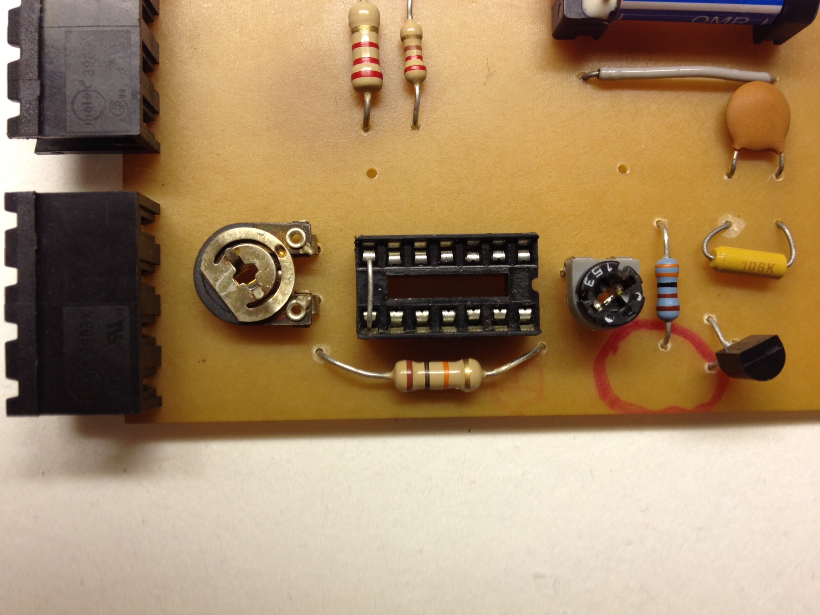

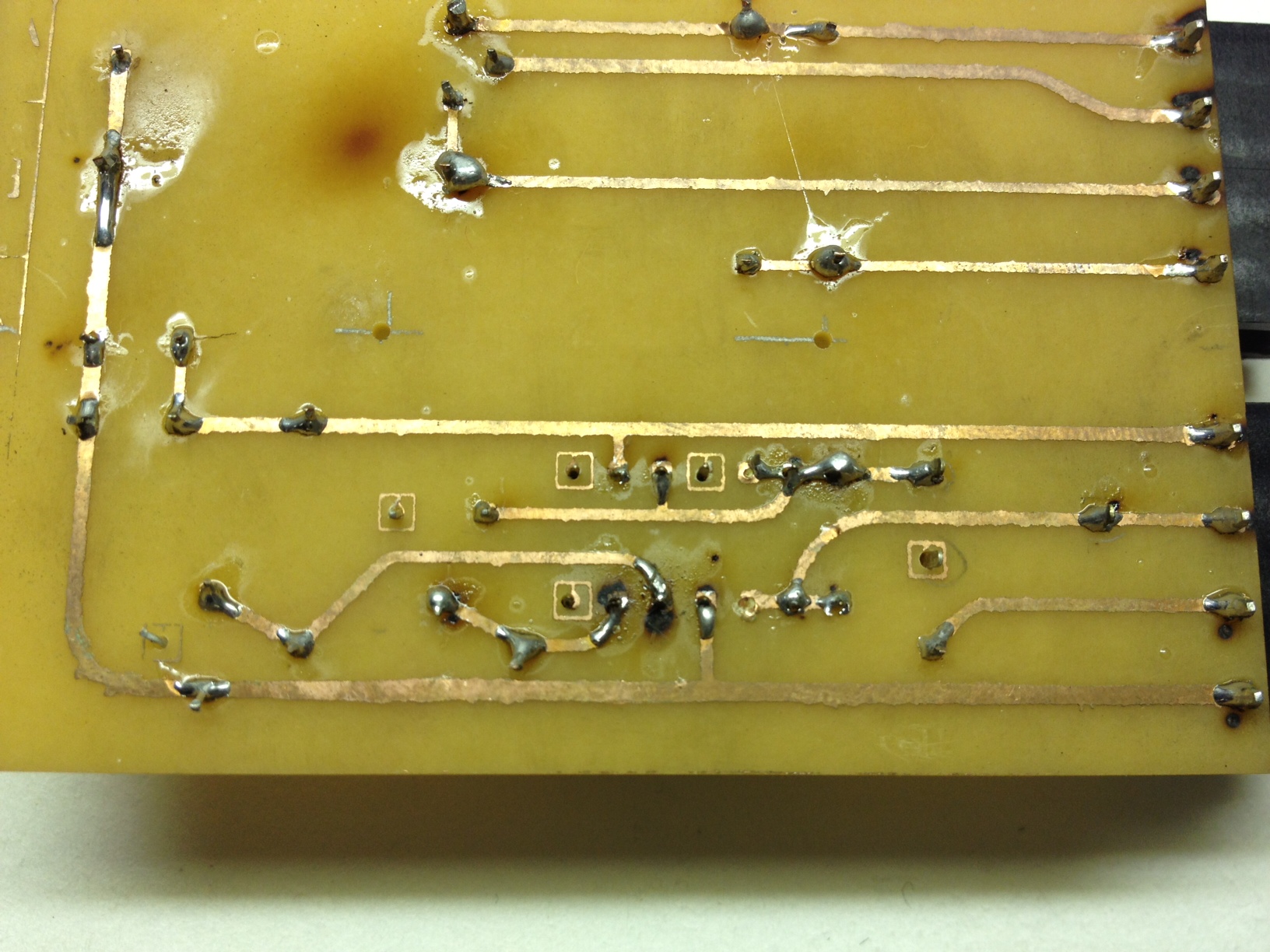

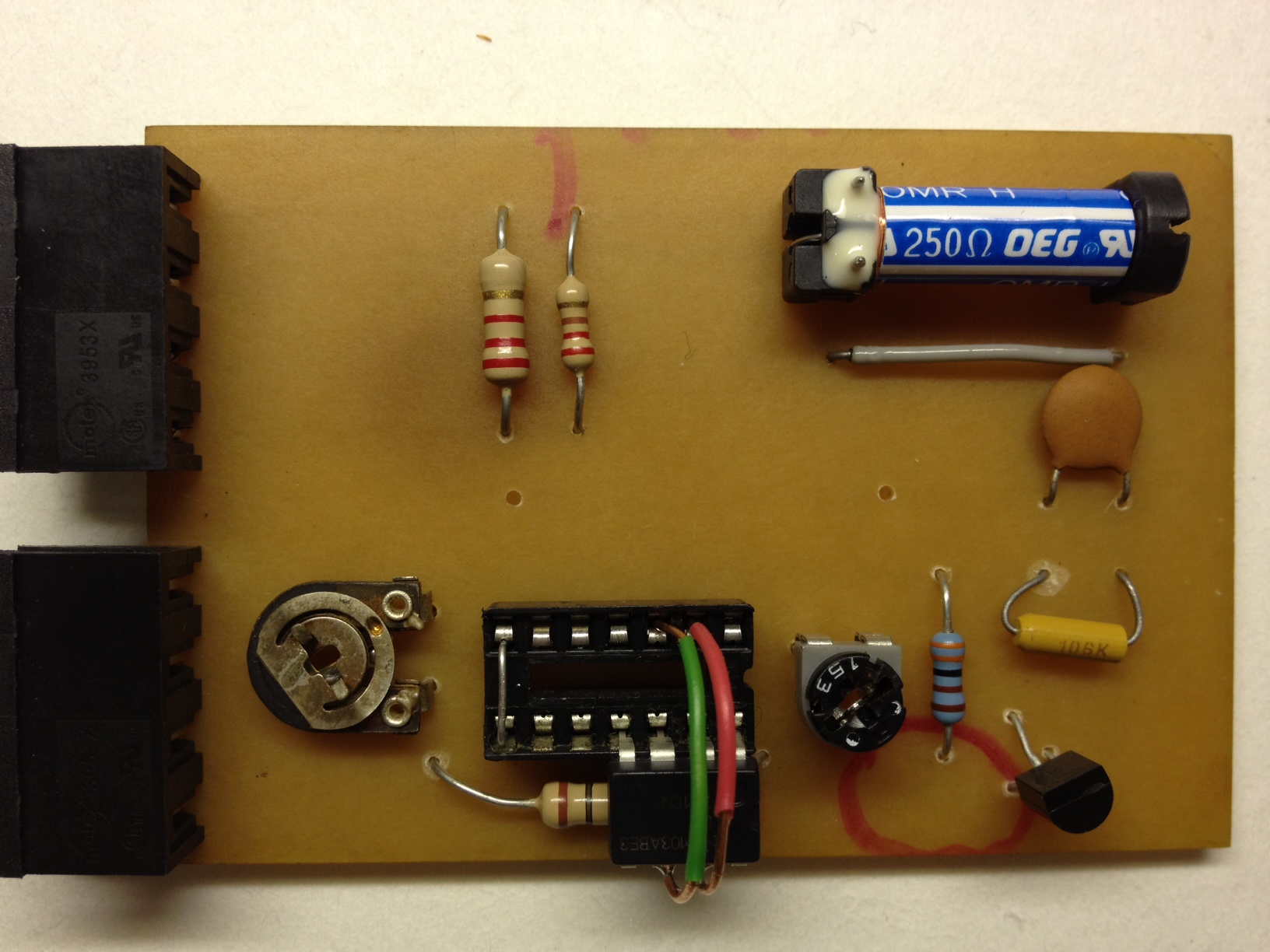

The circuit in question is on the lower half of the board in these photos. From top to bottom the four external connections on that half of the board are +12 V, output to instrument panel (5-0 V = 0-100% state of charge), input from battery monitor (0-5 V = 0-100% SOC), and ground. IC mounting is a little unorthodox because (if you couldn't guess) in my hurry to get this built in time for the Thanksgiving holiday, I designed the PCB with the IC mounting points backwards. The unused pins in the IC socket are meant to be used to add resistors (or in this case a plane wire to eliminate variables for troubleshooting purposes) in parallel with the potentiometer on the output (which is there for fine tuning, since bench tests of the gauge indicated that it'll read 100% at more like 0.5 V than 0 V). (The other potentiometer is in place of R2 in the aforementioned schematic, to fine tune feedback resistance.)

Trying to make sense of your inverted layout.:D

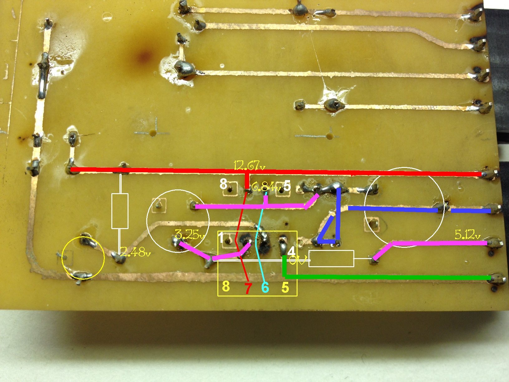

Please post the voltage measured on each IC pin of the OPA relative to 0V

IC pin voltages as follows:
2: 3.25 V
3: 2.48 V
4: 0 V
6: 8.4 V *
7: 12.67 V
Supply voltage was 12.67 V. Input from the battery monitor was 5.12 V.
*: 8.4 V was the final measurement on the output pin. Initially it was around 5 V as before but, more interestingly, when the PCB was disconnected from the instrument panel, the output dropped to 1.34 V, which would almost be correct, except when I tried adjusting the R2 potentiometer it never did come down to the expected ~0 V, and only when I cranked the pot almost all the way in one direction did it increase a bit.
I suspect your problem is not on the pcb, but how it is connected externally.
