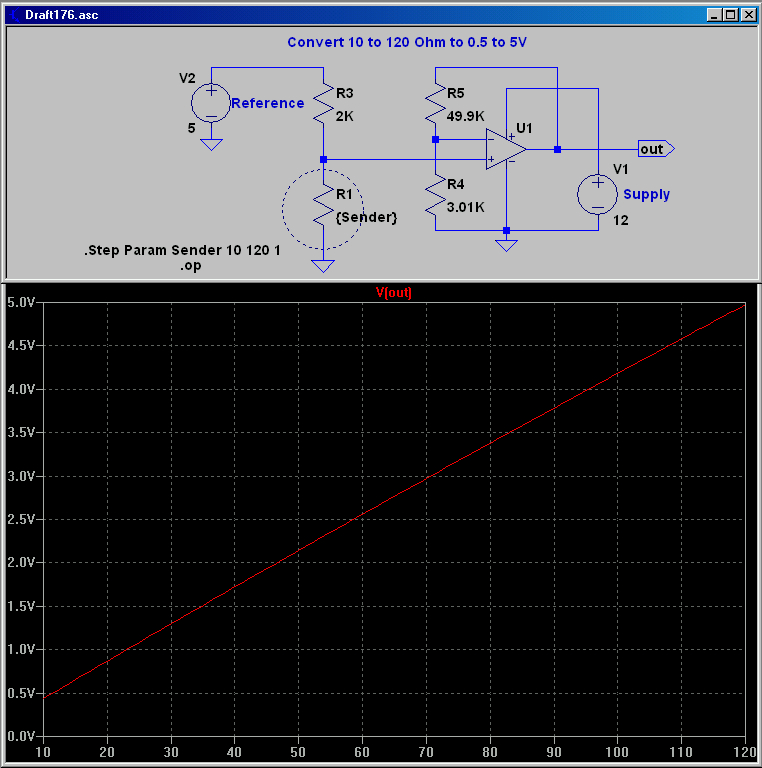

Assuming the 5V output can source at least 50mA the simplest solution IMO is just to connnect the stable 5V to a 120Ω resistor in series with the sender, then use the ECU to measure the voltage across the sender. For a 10-120Ω sender this voltage will vary non-linearly from 0.4V to 2.5V. A lookup table would then give fuel volume as a function of measured voltage.
Here is a simple circuit that converts a sender resistance change from 10Ω - 120Ω to 0.5V - 5.0V. The voltage out vs resistance is quite linear. It is simple to rescale the output voltage to correspond to other sender resistance changes, or other reference voltages, if needed. An LM358 would work for the opamp. Not shown is something to clean up the supply voltage...

What I posted is a schematic. You are asking for a pictorial diagram which shows physical parts. I dont have time for that.
You can do it. Start by printing out the data sheet for a LM358 op amp. It will show you pin numbers, etc. Get a piece of perf. board. Make a xerox of the bare board. Start placing components such as to minimize wire lengths.....
