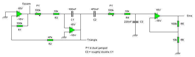

My professor wanted me to try to make a Function generator by not using does ready function generator chips.
Internet has a bunch of that kinds of function generators, But Can you guys tell me the best one's in your opinion or maybe that one's which you have made and are satisfied with?
Thank a bunch.
It depends on what functions you need at what frequency range?
Here's a couple of ideas.
The circuit for the triangle wave generator is the site linked below.
I can't remember where I found the wave shaper from, I think it was EDA?
The resistor values in the wave shaper are critical and should be 1% tolerance of better resistors, 5% isn't good enough.
The filter has the disadvantage of requiring a dual ganged pot and having to vary both C1 and C3 when changing the frequency range.
The wave shaper based function generator, only needs P1 to be adjusted and C1 to be changed when switching ranges.

Thanks,
My professor wants me to try to get at least 1kHz (the Max is not important) and an amplitude of 10V when I try to make a function generator, Any idea please?

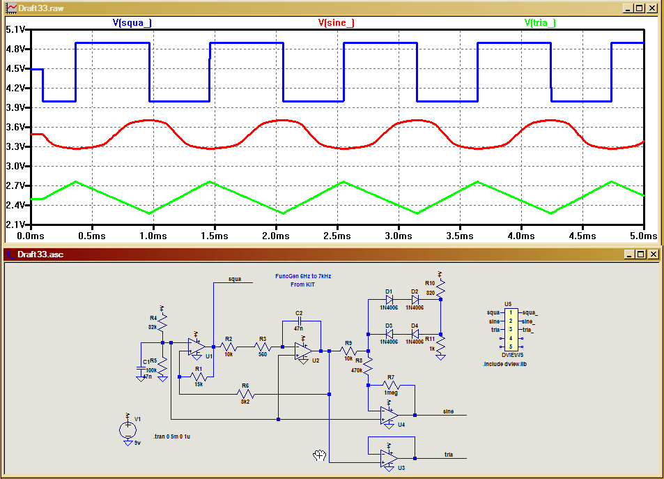

Its a quiet day, so here is your circuit running in a LTspice simulation, at approx 1kHz.
As you can see its a rough Sine wave.:)
EDIT:
This 2nd plot shows the actual voltage levels.

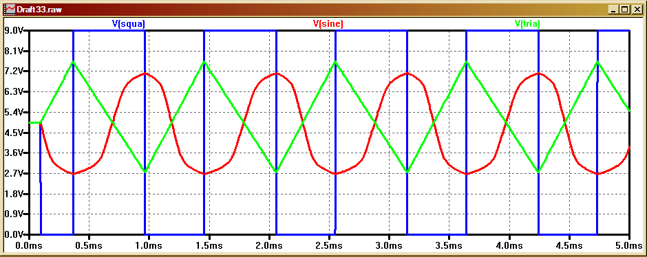

Thanks a lot for your time.
Yea, I have simulated it by Proteus software and noticed that the Sine wave is not so good, I could improve it a bit by adding a 10nF cap across the R10. How can I improve it yet?
Can I add another op-amp somehow to increase the output values? I want it to be adjustable so If I could use an op-amp at the output just a pot instead of the feedback resistor could be used to change the output voltage values.
By the way how could you get 9V for the square output At the right pic??!
There is a big difference between the amplitudes at the left and the right pics!!!!
The left plot uses that 'dview' option which allows the plot to show the outputs on separate sections of the plot, one above the other.
The right plot is showing the actual voltage levels as measured, the reason for the 9V square wave is that the OPA's are set for rail to rail.
The form factor [quality] of the 'sine wave' output will change as the frequency changes, you may have to add a 'form factor' pot so that you can trim for the best sinewave at different frequencies.

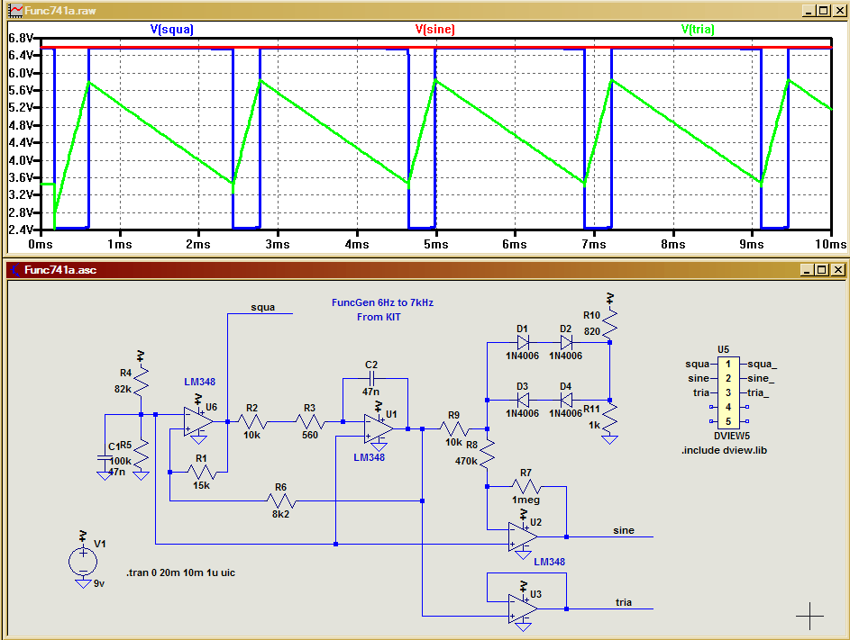

This is a plot using the LM348.
Compare this to the previous OPA, it shows the difference.

Yuck, that's a poor excuse for a sinewave.
Both the circuits I posted make a better sinewave than that.
The simple RC filter shaper gives a reasonable sinewave.

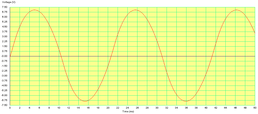

Here's what the waveform looks like with the component values given above:
See, it isn't perfect but it's better than the kit.
It can be improved by increasing C3 but the gain needs to be increased (increase R5) which will reduce the maximum usable frequency.
As you seem to be pretty new to this, I'd recommend going for the basic RC filter wave shaper.
