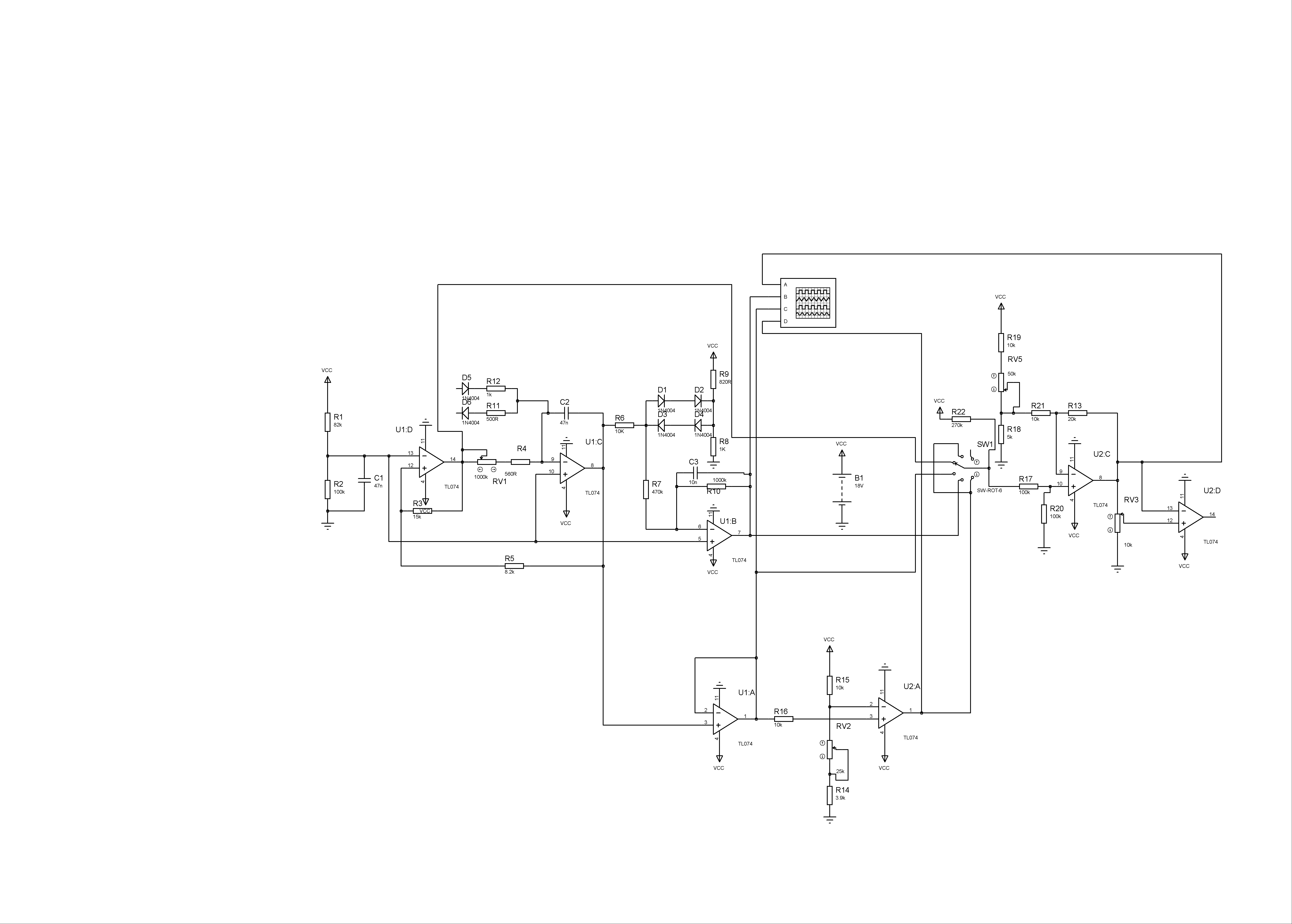

I just Trying to say you that I Made your modification on post NO 33, but U8 and its pot (R21) just change the amplitude of the output (i.e the amplitude of the waveforms),
I tried it on Protues software and then in real by my real components, And I have to tell that U8 And R21 are in a configuration so that change the amplitude, They do not change the DC OFFSET a tall! Any solution?
Here's my configuration based upon your mode,
Please take a look at the U8 & U7 section for any misunderstanding.

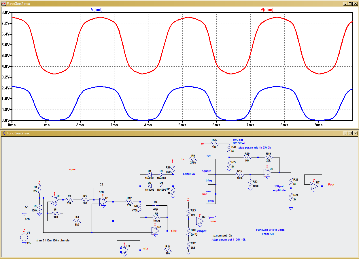

There will be some interaction with R21 and the Gain of U8, you will need to adjust R23/24 10Kpot to compensate. I was trying to keep the component count as low as possible.
If you want a high specification Function Gen it would require a complete redesign and more high spec components.
Varying R21 should change the DC offset of the output waveform.
You do realise that as you have a single supply to the OPA's that the output waveform will always be above 0V.?
I will look at your circuit..:)

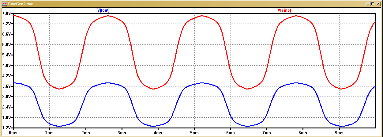

Look at these images, R21 = 5K and 40K , observe the DC shift on Vout.
EDIT2:
I see you are using a 18V supply, the original circuit from the web says 9V.??
I used 12V for my sims, I will retry at 18V

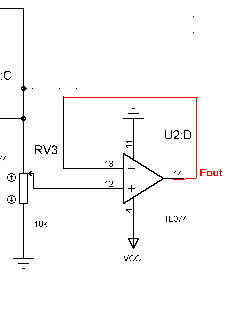

You have the DC select wired incorrectly on your circuit.
Look at this edited image.
EDIT:
2nd image showing circuit error.
