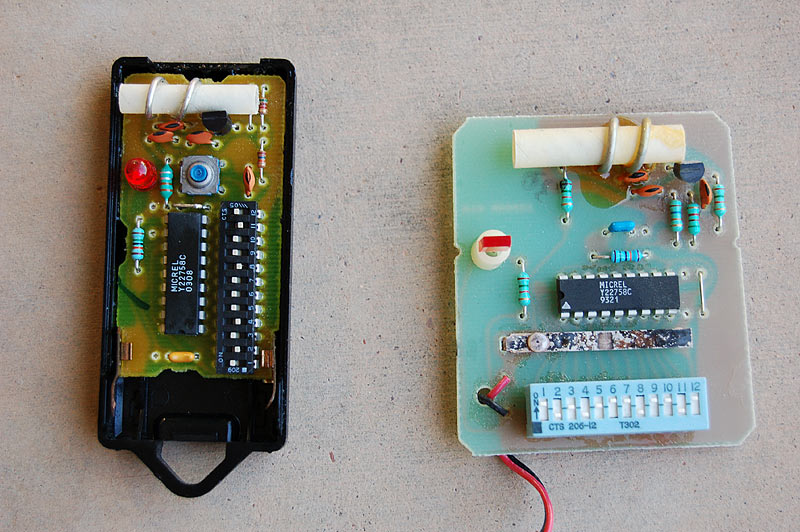

Is there any chance you could snap some pics of your transmitter so that I know kinda what to look for when I go fiddle with mine?
I took some pictures of my transmitters, and I don't see anywhere to put a screwdriver to tune anything. Am I missing something, or does my transmitter lack this function?
These two are different transmitters, but look to be the exact same circuit, just laid out differently.

Shouldn't it be on the receiver? It would make more sense. :)
I am sorry, but i have to disagree with Rolf. It wouldn't think that the POT would be the receiver. If you don't believe me, then just pop the lid off of the receiver. I bet it is in there.
poopeater said:
No, Rolf specifically said to tune the transmitters.
The only tuned circuit I see is the coil wound over the white tube.
Is there a slug inside? If it is you are lucky, because you will have to tune it slightly.
If not, the only way is to compress or lengthen the space between the windings. To determine what to do, you need a tuning tool, it is a small dia. stick with a powdered iron slug in one end and a brass one the other. But it is almost impossible to use without proper test equipment. Sorry about that.
I don't know what else to suggest.
The type of receivers used I have no experience with but maybe, if this don't work (please do not play with both of your openers) you could post a picture and we could work from there.
PS. As a temporary fix you could double the length of your antenna, that should help some.
Here is what mine looks like but it is almost 20 years old.

Yes, there is a metal slug inside the white tube. It's not powdered iron, and doesn't appear to be very fragile. How would I go about tuning the coil using this slug?
