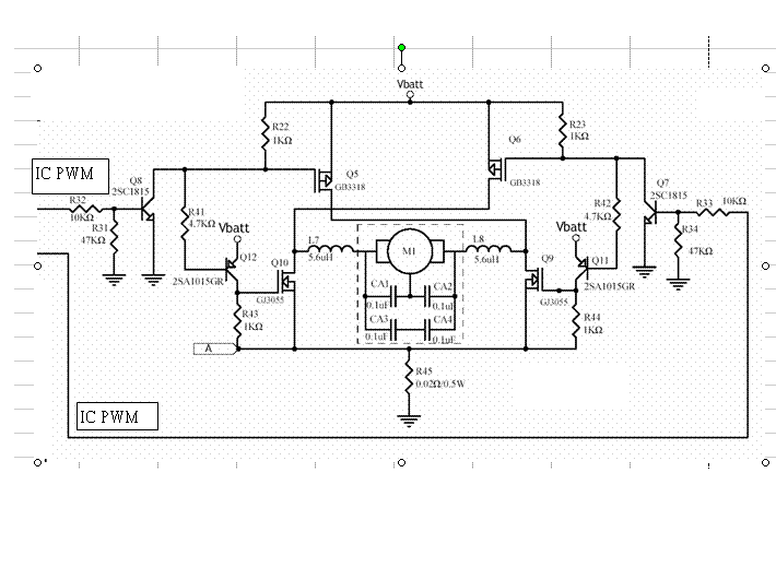

I'm using a type of P-channel mosfet in my project.I find this mosfet is easily damaged whose gate and source is short.I guess the cause of ESD.There is no High voltage and no big current occur in Mosfet,but the defect samples can be picked up by our testing fixture.I know Mosfet is sensitive static electronic part,but How much ESD will destroy the Mosfet,I don't know?Looking forward for your help.Thanks!

I agree with crutschow analysis.Mosfets are sensitive static electronic part.we have weared an ESD wrist strap under operation.In my opinion,the cause of defect samples come from two side,one is coming material quanlity,and another is ESD.Now,we are still finding the true root of making problem.I attach the driving PCBA schematic for your reference.

What is the value of the Vbatt.?
Have those capacitors and small inductors around the motor been fitted to reduce EM radiation into the radio section.?
My first point would be that FET's are not being protected against 'electrical switching spikes' from the motor, thats why the FET's are failing short circuit.
the body diodes of the complementary FETs will handle the time between the switch of the h-bridge. that is, of course, if they are rated for the current that is going through them. It would probably be prudent to put some schottky's across the FETs to reduce losses anyway.

Spoke to this guy on the chat line yesterday, apparently the P MOS FETs keeping dying on the production pcb's while on test.
Failure mode he says, is blown Gate/Source short.
Good idea to put some 15V zeners on the gates to dump any high voltage spikes. Also need snubber caps across the drain-source pins as physically close to the FET as possible.
And as mentioned, freewheel diodes are needed to provide a path for the inductive kick from the motor. This is probably what is blowing the FETs, since it's either going to develop a high enough voltage to breakdown the gate-source junction, or it's blowing the reverse diodes due to too much current. Do NOT rely on the MOSFET built in diodes for the freewheel current. They are not meant for that purpose and have very slow recoveries, which can cause problems if you are switching faster than they can recover. Put the diodes close the motor.

From what he said on the chatline, he has made a test rig to determine why they are failing after build during final testing.
But he now also concerned that his test rig maybe taking out the FETs'!!!!
He also suspects the 'quality' of the bought in FET's maybe low.
He is also not confident that ESD rules are not being applied during assembly.
I suggested he makes up simple pre-assembly test rig, get a good sample batch and follow them thru production.

most likely failures I have encountered include thermal stress, overdriven (Vgs > 10v), or reverse bias (Vgs < -10v).
other than that, they are pretty robust.
ESD is mostly affected by environment though, which makes it very hard to determine what might be causing it. Your environment may naturally have low static build up, where wealth's environment might be very prone to it.
I have never had problems with ESD either, but I actively try to keep any static buildup to a minimum. I agree that it's probably the lack of FET protection in the circuit that is blowing the fets.
