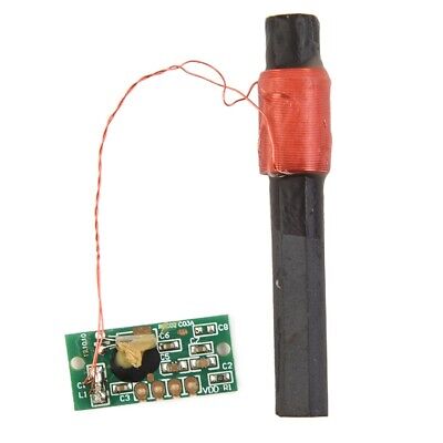

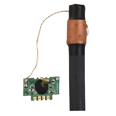

For a cheap and low power self-setting add-on, use a time signal receiver; DCF77, WWVB or whatever suits the location.
You need a single input on the MCU (or an output as well to power the receiver if you don't want it on continuously).

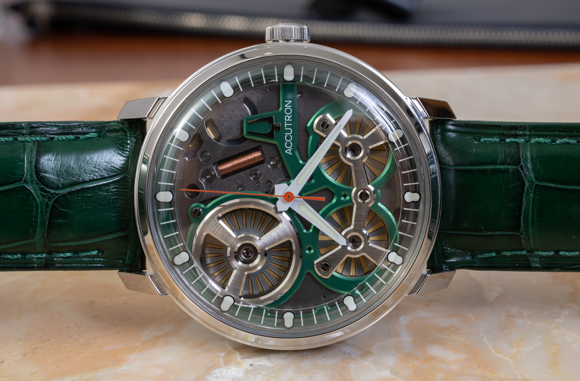

Some Seiko watches use a movement-driven generator:
A recent Bulova watch movement claims to use an electrostatic generator & motors, looking rather like tiny Wimshurst machines:
Damn that Bulova watch is quite beautiful only if it did not cost 3650 dollars.
